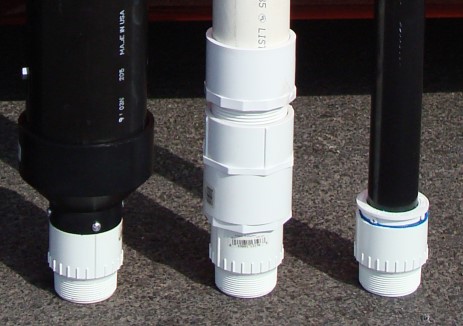

Before you flame me, all parts that weld ABS to PVC was done with "ABS to PVC Transition Cement" and reinforced with bolts and nuts.

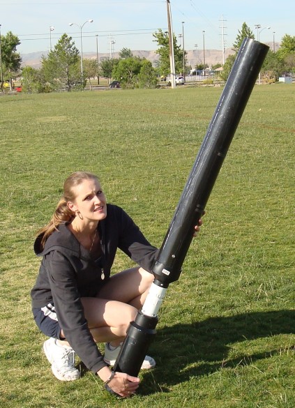

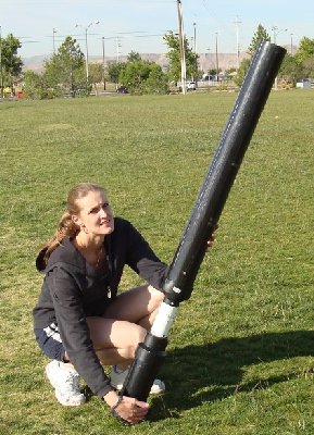

My girlfriend firing a softball

fittings reinforced with bolts and nuts

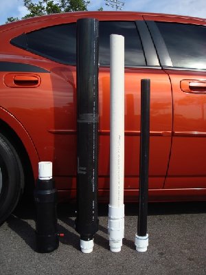

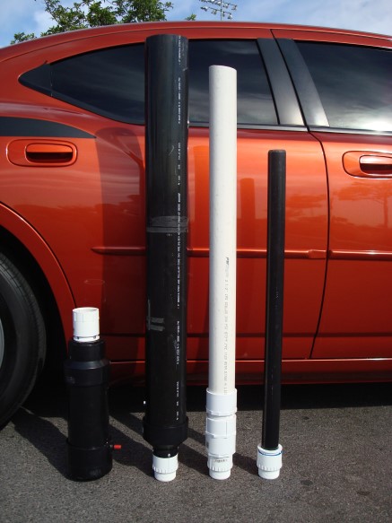

Here are my different chambers so far. 4" softball barrel, 2.5" tennis ball barrel, and 1.5" potato barrel
ABS to PVC Transition Cement and nuts and bolts to strengthen it

My girlfriend about to launch a softball into orbit

I like the versatility of multiple barrels, just a little concerned that with the softball barrel your chamber/barrel ratio may be a little small?
But if it shoots well, i guess it's no matter...

That's a supremely small chamber to power that softball barrel.

The softball is seated 6" above the connection joint on a large bolt so that makes the combustion chamber a little bigger. With wadding, the softball is going about 150yrds before it lands. I could make it bigger but it fits so well in my car just the way it is. :D

Your c:b ratio when using that softball barrel is pretty darned low...like .25/1 or less. You are losing some performance with the barrel that long on that chamber. A barrel 1/2 or 1/3 that size would actually increase your performance.
However, it's kind of cool to see a low noise combustion in action...about the only good side effect of the long barrel.
Great effort on the interchangable barrels, indeed the gun as a whole. You can keep your barrels and design an advanced metered propane chamber to drive them.
BTW, the spud barrel could use some more length to it...another couple of feet would make a noticable difference.
Edit: OK just read where you placed the ball 6" up in the barrel. That's better, just dealing with the weird chamber constriction at the "breech". I still believe you should still try a shorter barrel with the ball seated at the breech.

Nice cannon, man. Now I'm inspired to try an interchangeable barrel design. As others have pointed out, a larger chamber for that barrel will give you quite a bit more push... I don't think the overall gun would have to be longer. I'd suggest going to a 4" pipe for the chamber, maybe the same length or just a few inches longer. That is - if possible with the types of fittings you're using. I haven't gotten my wife to shoot one of mine yet... congrats!

Boom_erang wrote:I'd suggest going to a 4" pipe for the chamber, maybe the same length or just a few inches longer.
Uuum that is 4" pipe on his chamber already.... :roll:
Boom_erang
Posts: 61
Joined: Fri Apr 25, 2008 2:26 pm
OOps... I missed that - scale I guess. OK - then longer!
