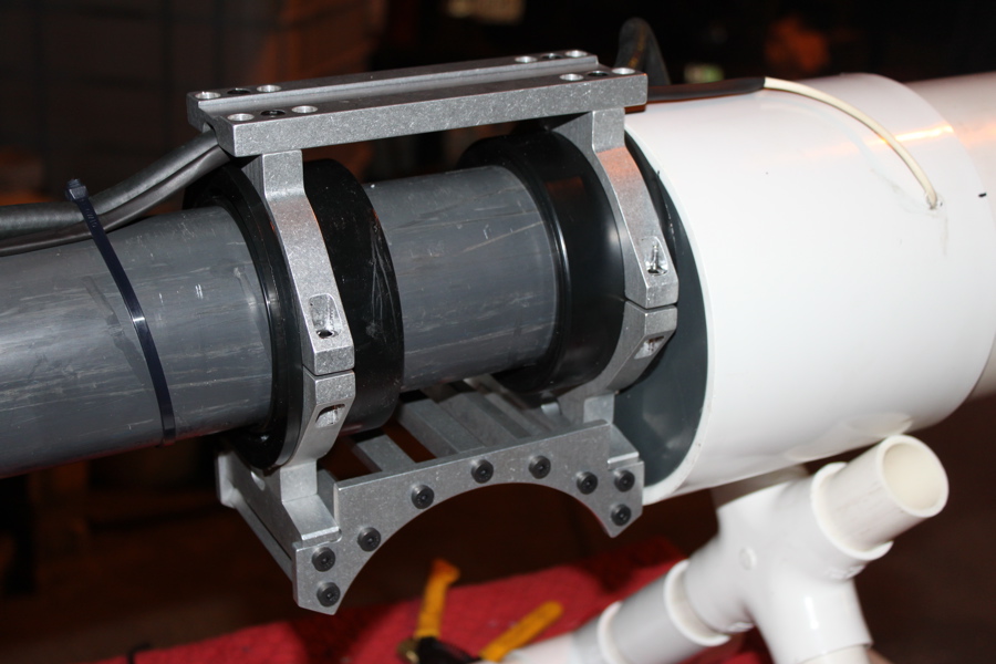

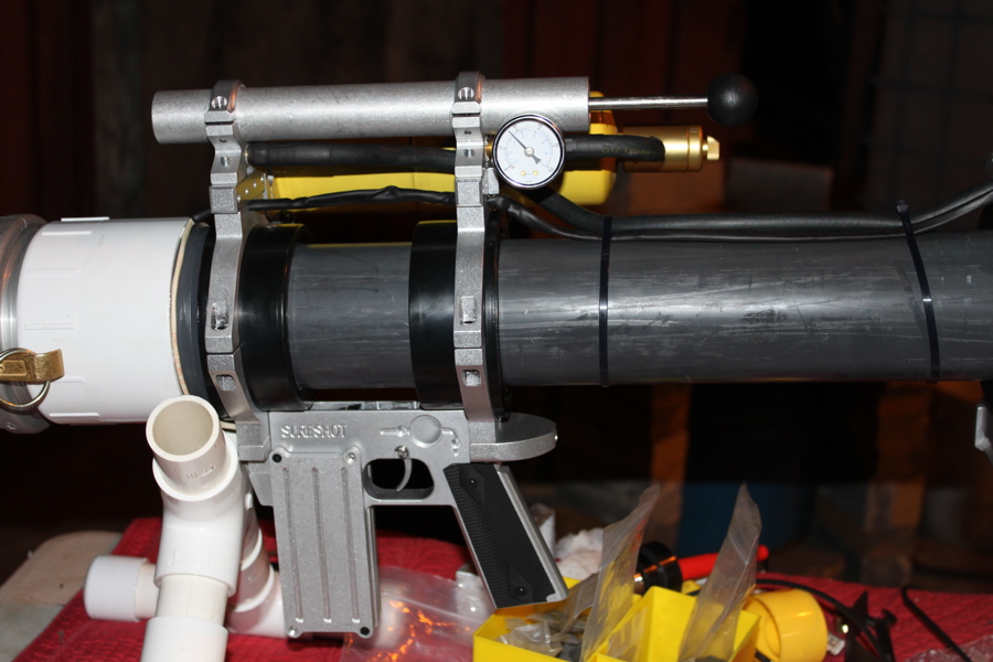

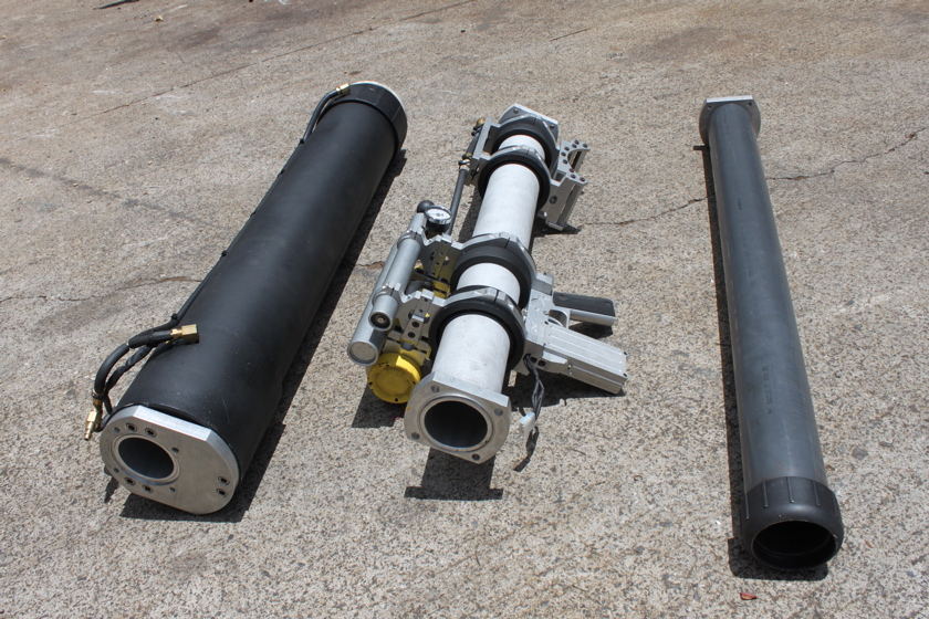

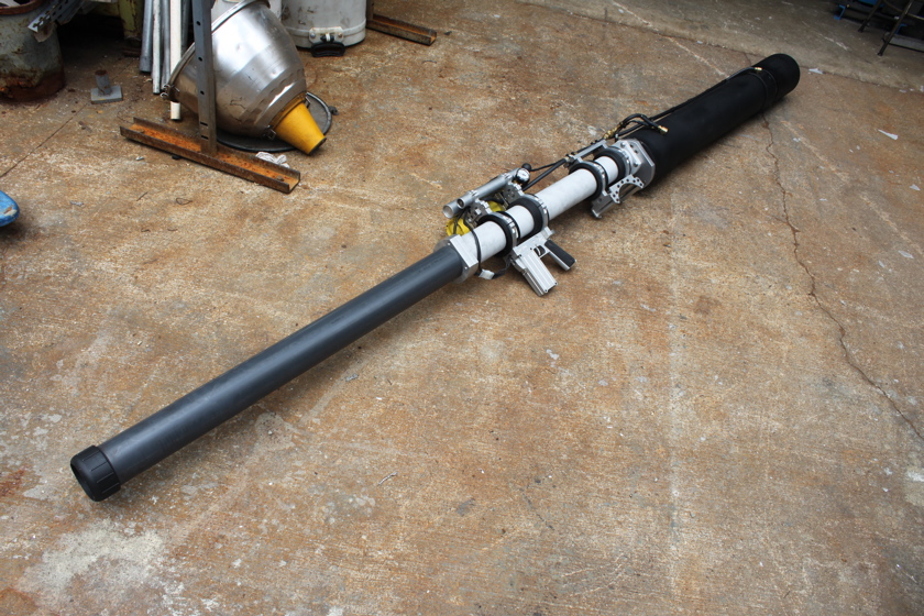

Just when you thought it wasn't going to get bigger...

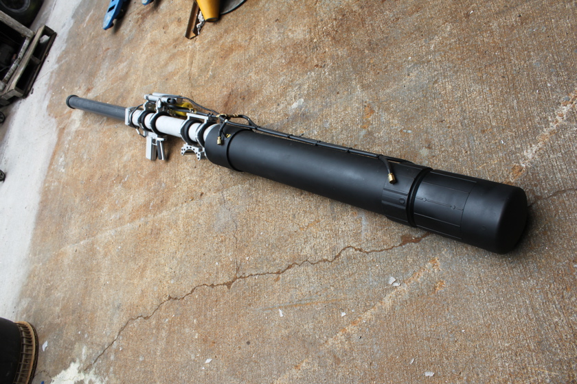

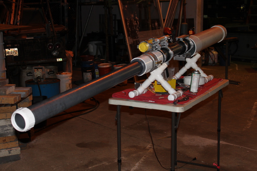

Here's the skinny
- 800 cubic inches of chamber
- 120" barrel length of schedule 80 3"
- 1:1 ratio
- twin igniters

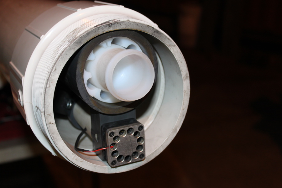

- chamber fan
- MAPP metering/regulating

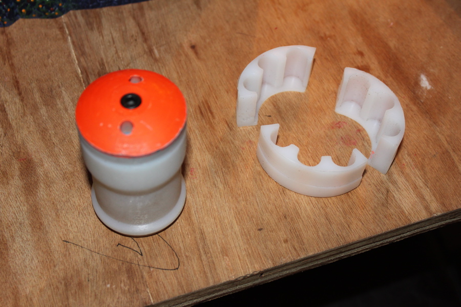

- Sureshot AL bits, custom shoulder rest

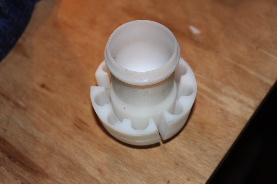

- Sabots to carry 2" UHMW compound rounds
- Estimated 750 fps with 232gram UHMW compound round good for a few thousand ft/lbs. of energy
This is a prototype developed for an international defense contractor.
Videos hopefully if its not shipped to soon.
Hey JSR... sabots finally!
BL-630 with videos and pics

I'm sure recoil on that will be quite...noticeable, considering it
only has like 4000 ft/lbs, nice job again i would really like to see that thing in action
ggdt only predicts 624fps with my 1500ci 3" porter @ 100 psi so that thing must be a beast
i might need to make a huge combustion, just so i could have a beast like that

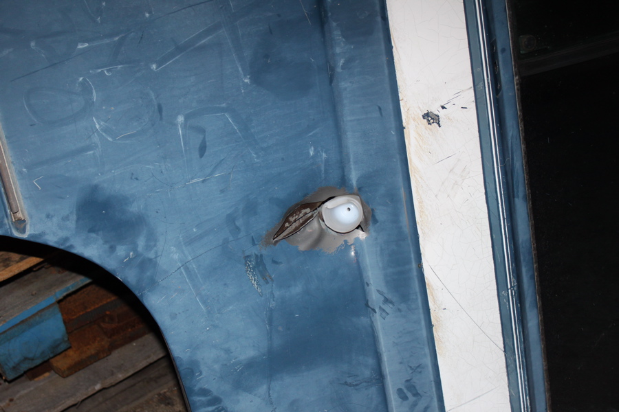

Brilliant job, I'm sure if that round had struck the centre of the door panel it would have happily gone clean through.
Any comments on the accuracy with sabots? From the design they look like the petals should come away quite cleanly. Also I like the fact that the sabot projectile is from the preceeding calibre, the Germans did this in the second world war where for example the sub projectile for their 88mm APDS round was the full calibre projectile from the 75mm gun.

Excellent sabot design.
Is there any means to "tether" the pieces together?

I think its got more to offer. We got everything operational and seeing it was midnight decided only to test a few rounds. We'll get the AF dialed in and get some chrony data.jackssmirkingrevenge wrote:
Accuracy not tested yet, but if you look at the photo you can see the 3 small dents where the sabots hit the door. The petals seem to have all hit equidistant from the round. We tested some 3" compounds -- heavy hitters close range but low CD.jackssmirkingrevenge wrote:
D
I'll see what we can do.jackssmirkingrevenge wrote:
One small thought, how about having the central projectile as a simple UHMW cup filled with say 100 0.177" lead BBs, or 10 0.38" steel bearings. The whole assembly should fly out at more than 750 feet per second, et voila, shotgun

Figure I'll give you guys an update. This large build has seen quite a bit of evolution and we've seen some interesting data. Looking at the data, a coaxial configuration may get better results (10%) with a 1.5 to 1 ratio than a 1 to 1 ratio.
C/B ratio = 897CI / 633CI or 1.41 / 1 ratio
Extended Chamber / Short Barrel / Gas set to 39PSI
677fps 676fps 661fps average 671fps
C/B ratio = 671CI / 633CI or 1.06 / 1 ratio
Regular Chamber / Short Barrel / Gas set to 32PSI
610fps 609fps 599fps average 606fps
C/B ratio = 671CI / 792CI or .85 / 1 ratio
Regular Chamber / Long Barrel / Gas set to 32PSI
614fps 617fps 658fps average 629fps
C/B ratio = 897CI / 792CI or 1.13 / 1 ratio
Extended Chamber / Long Barrel / Gas set to 39PSI
703fps, 699fps, 720fps average 707fps
Also, worth noting was the ignition placement. Initially we placed to igniters near the breech end and could make only 450fps. placing the igniters at the fore (furthest from the barrel) got us the numbers above.

Yes, We did not see the estimated 750fps with a baseball. But we did make some 3" compound rounds and put 3" holes clean through a car door! Pics to come.

Man that thing is big...even though I see what looks like a shoulder mount, it's probably not very practical to be handheld...could there be a ground mount of some sort in the works?
Love the sabot, love the monster energy available...
- Technician1002
- Posts: 5189
800 cubic inches isn't all that big. My 2 inch valve launcher is only 100 cubic inches smaller. It's slightly larger than 3 US gallons.
