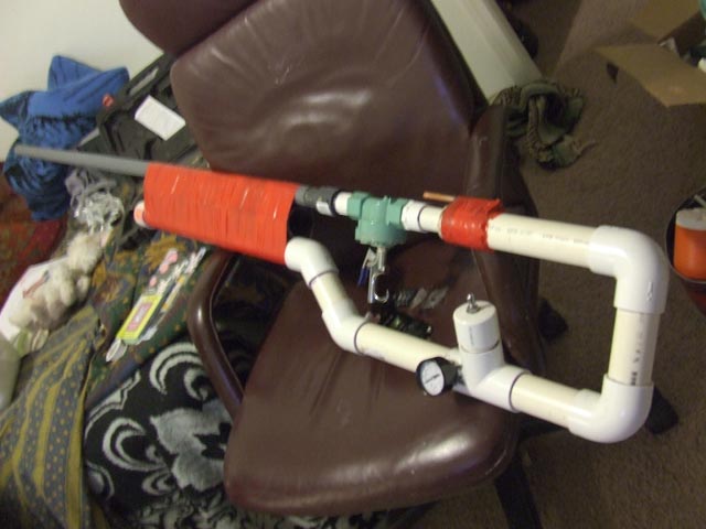

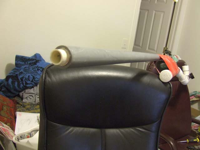

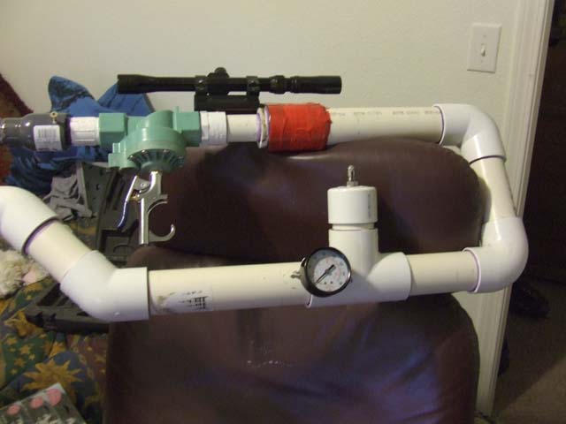

So this is my newest effort. I don't have a name for it as its not quite done yet (still gotta paint it and replace that ugly tape with something more badass). It is about 6 foot 8 inches tall. The chamber includes 5 foot of 1 1/2 sch 40 pvc and a bunch of fittings. the barrel is 1/2 inch by about 4 foot, not sure the type of pvc, but it is pressure rated (said 318 psi on the side). It is much thinner than sch 40. I used it because it fits marbles and as a barrel it doesn't hold much pressure. I sleeved the barrel with some electrical conduit because it was flimsy otherwise. the conduit was just laying around in the garage.
I know the chamber size is overkill, but I don't care. I use a big and fast compressor and air is free.

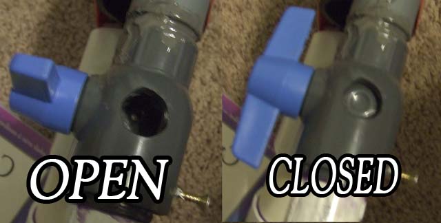

The breech loading mechanism is something I have seen on these forums in a few threads (thanks for the inspiration!). Its a ball valve with a hole drilled in it. Its rated at 150 psi (the lowest rated piece on the gun? whats a 1 inch sprinkler rated at? I have heard people say they take theirs to 160.)

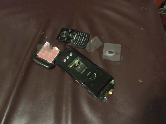

and my favorite, what this thing did to a cell phone

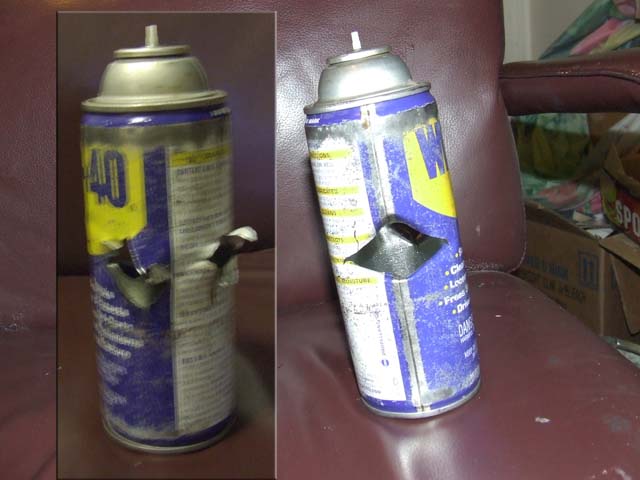

entry and exit wounds to a can of dw-40.

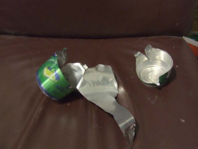

a shook up unopened soda can I shot.

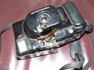

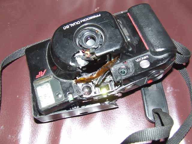

an old camera I shot
the barrel
the barrel
the modified ball valve breech load system.
detail of the chamber (most of the chamber at least)
the beast.  the small piece of copper on top is a scope mount.

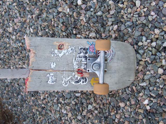

skateboard exit wounds... my big bore combustion is the reason its in half.

by the way, shouldn't you have take the flash circuitry out of the camera first?
haha, maybe. Call me old fashioned or call me retarded. But I prefer those flint twist igniters for my combustiones.

I like it. Does the barrel have a detent to keep the ammo from rolling out?
Could your barrel be SDR? Did a job on that WD-40 can for sure. They are made from heavier gauge steel. Try a full can of Cambells soup. Nice!

jook13 wrote:whats a 1 inch sprinkler rated at? I have heard people say they take theirs to 160
around 150 - 160 psi
down my way i can get sprinkler valves rated to 250psi though :D
right on, thats what I figured. And I wanna get my hands on one of those sprinklers!
It says pvc1120 on the side of it. I shot a can of green beans but didnt get a pic because I didnt want to bring the drippy can home (didnt have a camera with me). I am going out again today so expect more damage. a video perhaps?
Yup. The screw keeps the marbles from rolling back into the chamber and an O-ring is in there to keep things from rolling out the barrel. Though the marbles are kinda variable in size so the smallest ones still sometimes get past the o-ring
