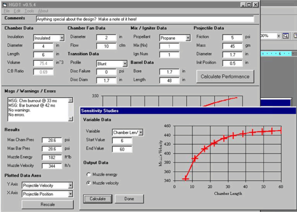

I wouldn't worry too much about the chamber volume. Pick your barrel length then put the largest volume chamber on that is consistent with the overall size of the gun and how you want to use it.
A CB of 0.8 maximizes the efficiency of the chamber. To maximize the performance of the barrel you generally need a chamber larger than CB 0.8. So, if your design is based on the barrel length and diameter, and the ammo, then the optimal CB is not 0.8.
For high sectional density ammo (like a golfball) the maximum muzzle velocity will probably be with a CB of perhaps 2 to 3 (that's just a WAG). That means that for a particular barrel a chamber larger than CB 0.8 will increase the muzzle velocity.
HGDT says the CB should be very large, ~7:1, to get the most out of the barrel and ammo combination. That CB gives a chamber that is probably impractical. Looks like a CB of 2 or 3 will outperform the CB 0.8 by enough to make it worth considering while still giving a gun with a reasonable overall size, weight etc.
(Interestingly, at very large CB ratios HGDT predicts a "mine-sized" chamber affect, the muzzle velocity eventually starts to drop as the chamber volume gets very large.)
EDIT: I had to guestimate the friction for the HGDT analysis. The inlayed sensitivity analysis graph shows the affect of different chamber lengths (which is proportional to chamber volume) on the muzzle velocity. The CB 0.8 gun has a chamber length of about 7". A CB of 3 would need a 26" long chamber. Everything was calulated based on a 1.7" ID barrel and a 4" ID chamber.

Whats that program called? I googled it and nothing came up.

look in "D_Hall's" signature.

Sorry, I usually include the links to programs;
Hybrid Gun Design Tool
http://thehalls-in-bfe.com/HGDT/
(A generic combustion gun is a hybrid gun with burst disk that fails at 0 psig and is fueled to 1X.)
HGDT is only a month or two old but it is in Google already (search HGDT hybrid gun).
