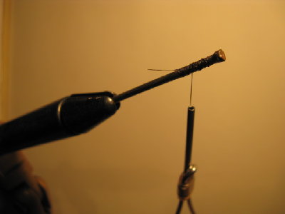

2- The first thing you will need to do is put the point of the nail in the vice, and put a few wraps of thread on the back

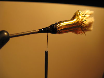

3- For these darts you will need this flash minnow body material, or some other similar material

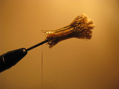

4- Cut a small section of the flash minnow body material and carefully slide it over the back of the nail like this-
5- Take your thread and wrap the front of the flash minnow body material so that it is secure. Then, with your thread, put several half-hitches around the wraps and then coat them with clear nail polish, super glue, etc.

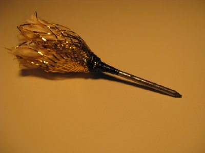

6- When everything is dry, take the dart out of the vice & unravel the back so it looks like this & your done!
