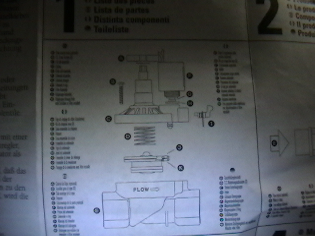

Yeah, there is a big a55 spring in the sprinkler valve that presses against the diaphragm. When I modded the valve I removed the top plate to avoid accidentally dremeling the diaphragm, I then discovered the spring... here is a pic of the diagram from the valves box... the valve doesnt have the flow adjuster like the diagram shows... see figure D for the spring... and yes it is inside

Maybe get the spring out, pull at it so it becomes longer, not too hard, but hard enough to deform it permanently a little.
The streched spring will now act out more force when put back in.
But be careful, stretch it too much and it becomes useless.

I tried that, and when it didnt work I assume that my problem is as DYI said in the first reply, I just need to get more pressure in faster... I ordered a threaded schrader valve from bcarms(and a GB barrel!!!) since the valve I have now leaks til 20 psi which sets the inner seal, and due to the rubber exterior it wont take epoxy.
