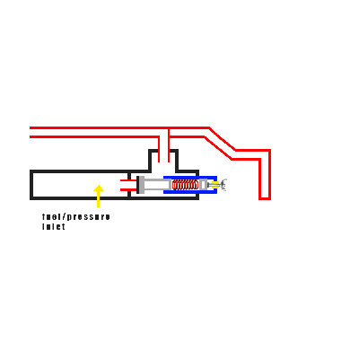

I am deciding to make a hybrid with a piston instead of a burst cap and i had a few questions.
1) With a PVC schedual 40 gun how high should I take the psi up to before combusting the gas?
2) is a typical charcoal lighter strong enough to ignite the gasses? (considering the compressed water vapor in the chamber)
3) are pistons commonly used in replacement for burst caps?
When im finished with my diagram on photoshop ill upload it and you guys can critique.

ok thanks. ill have to think about this one. if i can figure out how to upload my diagram maybe it's a good idea. But the initial intention of my plans for this gun were not high pressure, but rather, fast release/ immediate force on the ammo. If i keep a low pressure in the chamber (30-40psi) and keep the spring at a low compression force to mirror the 30-40 psi then it should open relatively easily causing (hopefully) minimal pressures in the chamber.

so im just curious, but why dont more people use pistons? it seems like a pretty decent idea (btw i have decided that the chamber be made of steel- everything else can be PVC, dont worry i wont kill myself now)
SEAKING9006
Posts: 734
Location: Texas
In a hybrid, you want to release the gasses at their peak combustion pressure, not at the storage pressure. Also, nobody uses pistons because springs are either unavailable, expensive, or they just plain won't work at the pressures used. Pistons used in pneumatics are set so the tank does not push on them, and are actuated by a pilot valve rather than the chamber pressure. A burst disc is INFINITELY more usable and design-friendly. Also, setting the spring for the storage pressure won't accomplish anything. It will simply leak gasses very slowly until the pressure is low enough, just lower than the spring force. I really suggest you take some kind of physics class or at least do some kind of online learning thing to learn about pistons and springs, and how they work. If you aren't completely sure how something functions, don't try to incorporate it into something that will experience super high pressure spikes and temperatures over 150 degrees Fahrenheit.
