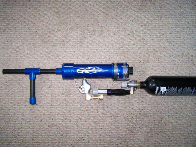

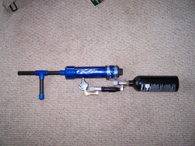

Fully portable bbmg.
177 bb,s
capacity 4000 bb,s
20oz refillible co2 tank
pmi evil detonator regulator
Uses 20oz of co2 to 4000 bbs.Will be putting a plunger in soon.Should increase bb to co2 ratio.
fp bbmg
Very slick bbmg you got there!
Have you thought of using a pressure washer handle as a tigger? They always seem to put that next level on a pnuematic...

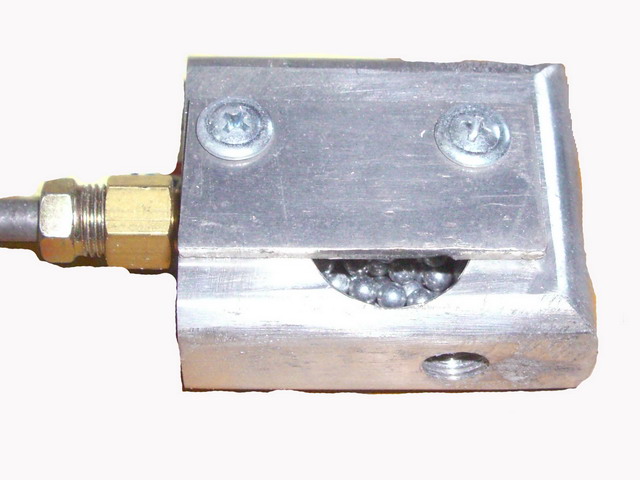

What did you make your block out of?

Very nice bbmg.
I've been thinking of one with an 88gr. co2 somehow.
Is "evil detinator regulator" an actual name?

Nice way in using regulated CO2, although, wouldn't HPA be more powerful?
I mean, that if you are going to lug yourself all the way out to a fill station, why not hpa? wou could also use a scuba tank for your own station, all you need is a special fitting that you can get online, and a scuba diver's licence.

Nicely done, what's the regulator set at?
- Posts: 26220
- Been thanked: 352 times
Judging by the fairly sturdy construction, and remembering that actual chamber pressure in vortex/cloud designs is much lower than the output (from a 110 psi input, mine never exceeded 30 psi in the chamber), any chance of turning it up?
that block and the paint job is a beauty, great job. im sure it tears up targets like crazy. you mentioned a couple bugs, could one be a lack of bb's feeding constant? if so maybe grinding the side plates a little more so the opening will be bigger so the bb's will flow into the block faster and easier? again the block is really sweet.
