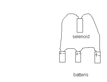

I mean this with no offense blind. Im sure you intended well, but he did not ask how to make it better or anything of that sort. He asked how to make what he had work. And i agree that pneumatic actuation would be better, but like i said, its not what he had asked for.
DEMON, im confused as to why it wouldnt work. I dont see why it wouldnt. Ive taken many things that run on batterys and hook them up to the wall with a cord. Maybe its different. Im no genious. You could buy the convertor, or you could search google and try to fix the current flow yourself.

I don't see why this wouldn't work. I have run a sprinkler solenoid off of a 12v DC gel cell for my rocket base, no problems at all. Are you sure you have your 9v batteries wired correctly?

Make sure you have it all wired like this. And then give it a try.
