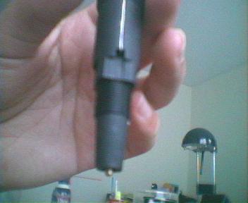

ROFL accidentally used wd 40 0_0 ROFL
ok and btw how would i stick an aligator clip to this
i current dont have any but would there be a plan b?
and also, how big should the spark be?

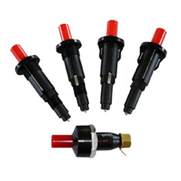

so how would i connect this thing exactly 0_0
There are two conductors coming out of the piezo crystal, one comes out the bottom of the unit, the other is embedded in the side, but visible. Solder a wire to the embedded one, and you'll now have two wires coming out of it. Attach one wire to one side of your spark gap, and the other wire to the other side. Can't really make it much more simple than thatso how would i connect this thing exactly 0_0
Also, don't worry about shocking yourself with it - unless it's on a sensitive part of your body like a finger, chances are you won't even feel it.

rofl alrighty thanks, ima get some thicker wires too, these are too weak
You might try taking a gander at the directions.
I only see 1 wire & 1 terminal on the plunger, so either it was a fluke on your photography or you have bought a single wire variety. This will present a whole new set of problems.
I think there is an "E-Z Igniter" out there that uses this config.
So first your red wire (black rubber end) slides onto the little rounded knob barely sticking out the bottom (furthest away from the button).
Now there should be either a little flat terminal coming out about 1/2 up the thing or you will have to figure out how it is finding ground (it will be something on the plunger that is metal.
If you find such a thing, you should be able to hold the end of the red wire very close to it and push the button and see a spark jump. Try not to touch either contact --- You'll know if you do.
Let me know how this goes.
- Example of a normal Igniter
- Piezoelectric_Igniter.jpg (20.26 KiB) Viewed 21347 times

rofl yeah it only came with 1 wire o_O
would attaching another wire to the metal thing embedded on the side work?
