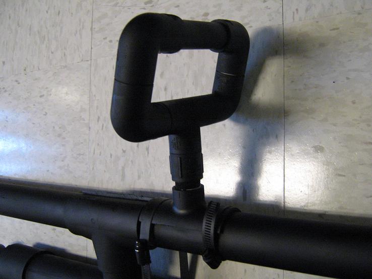

This is the handle, modeled after a minigun, of course:) It is really comfortable to grip, and it can be removed for storage, etc.

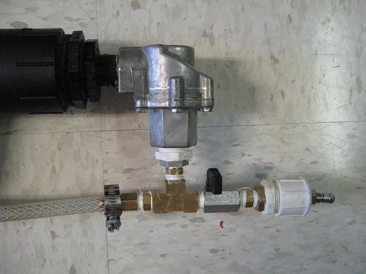

The pilot/fill setup. The tire valve will be replaced by a quick connect once I finish testing.

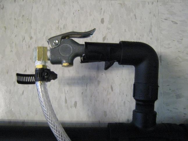

The blowgun is ergonomically inserted in the 3/4" pipe, and held in place with packing tape, which is easily painted:)

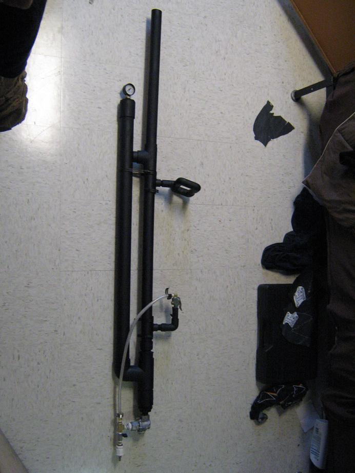

This is the gun. I had to stand on a chair on my bed to fit it in, and I'm 6'3"!

The schrader valve on the butt may get brutalized. There is a tendency to stand a gun up on its butt for several reasons so take care there. You might consider repiping it in some other way.

Yeah, good point 8) I am going to relpace the tire valve with a quick connect, but I need a ride to the home depot so I can get a 1/4" brass 90 degree elbow. Until then, It's gotta stay this way.
