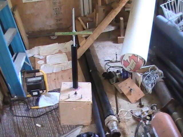

yes, DYI: that is why I use a penny switch (pic)
