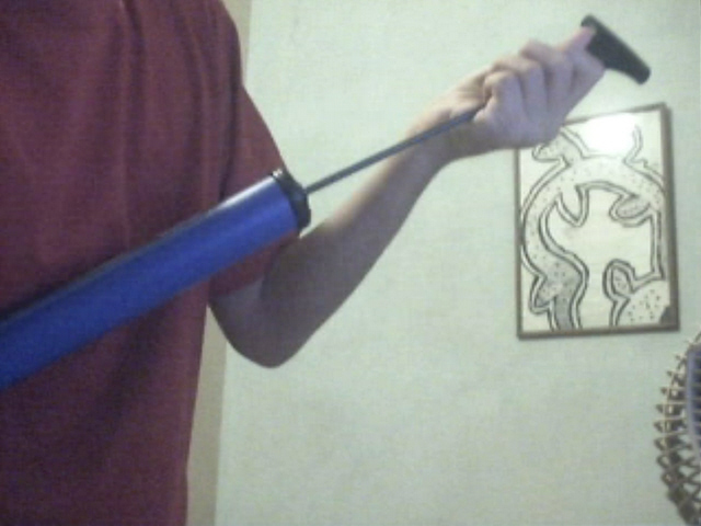

I have a great pump, and a want it to be always attached to my pneumatic cannon, but I need to modify it! see:
(the 1st picture shows the I need to modify it!)
Any ideas?!
Pump modifying

OMG! YOU NEED TO MODIFY IT!
Ehm... I can't really tell anything from this post, other than the fact that that pump looks like a basketball pump.
Here's a tip:
I hooked a basketball pump up to a scrader valve on an air carry tank at 60 PSI before. The whole handle and pump cylinder blew out of the pump and flew across my room and into a door, denting it.
Now do you really want to use this pump?
Here's a tip:

Like mark said, it looks like a pretty low pressure pump, probably something like 30 PSI max.
Looking at the picture, I would guestimate the piston diameter at about 1". That means to get to 100 PSIG you'll have to supply about 80 pounds of force. If the piston is 1.5" D then you'll need ~180 pounds of force to get to 100 PSIG.
EDIT: ENgrish
EDIT: ENgrish
that pump will kill u. i had one and was pressurizing a bottle with it until the cylinder snapped. it happened so fast and i couldn't stop my hand from going into the shards. i got a few to the knuckles. wasn't so fun when i was bleedin all over my new shirt.
THROW IT AWAY. it's meant for low pressure (sports balls). it can't even properly inflate a bike tire.
WHY PAY FOR IT WHEN U CAN MAKE IT?
You could "modify" it by replacing the shaft with smaller diameter copper pipe, a new piston+rod and a custom check valve. Oh wait, now there is nothing left of the original pump....

as every body said it! that pump can easyly kill you. make a better one from a thick pipe, or build a piston compressor, ally ou need is a strong check valve, a piston, metal rod, strong metal pipe, a metal disc, common sense and a strong electric motor!
