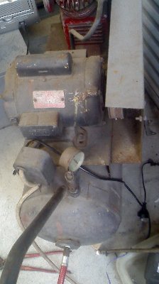

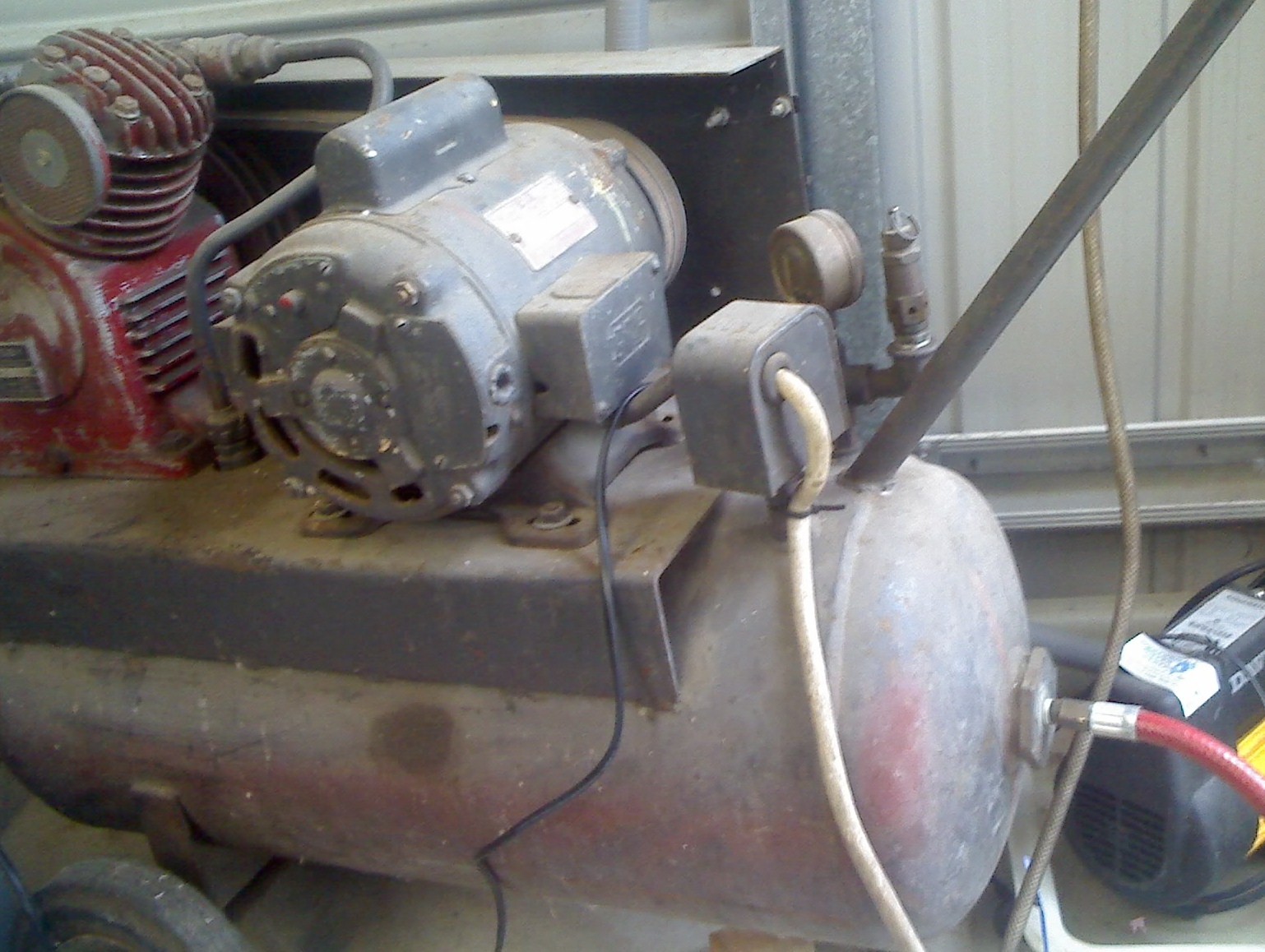

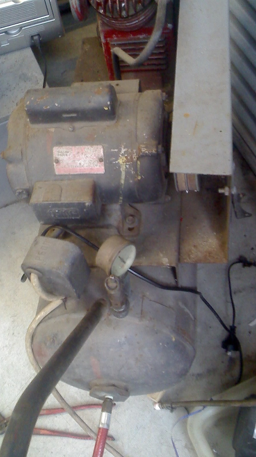

well i was wondering to myself if there is a way of modifying my air compressor so it fills above a missely 100psi which is pethetic considering the size of the tank and motor???
any ideas?

jack ur a fucking legend i now know what it feels like to shoot at 150psi,i want moar
all i had to do was turn the pressure screw about 10 turns for a 50% incresse in pressure

if you plan to pump a PVC gun with it you don't really need more than 150 psi and you shouldn;t try to get more with your compressor...
if you plan to build launchers out of metal it might be a better idea to build a simple AC or fridge compressor
the biggest problem with modifying an air compressors is not the compressor pump itself but the tank which is rated to normal compressor pressures (that is 8 - 12bar max)...
mind you that when you exceed pressure rating you risk your life (but so is exceeding the pressure raitng of the pump itself)
also your air compressor is used which might mean that there is rust inside the tank which makes everything even more dangerous

but with the pop off valve in place (it starts to hisss at 150psi),dont u think it would still be safe????

The tank itself is the dangerous part. That's why i've never done this. The inside of my tank is rusted to bits because I keep forgetting to let the air pressure out and sometimes leave it compressed at 80PSI over a week or two, all the moisture inside the tank ends up rusting the inside. I've seen tanks that have rusted straight through.FORE!!!! wrote:but with the pop off valve in place (it starts to hisss at 150psi),dont u think it would still be safe????
To be honest, in case the pressure was too much, if you're lucky it might just break a small hole in the rust and release all the pressure, there goes your tank but at least your safe.
That's what I was thinking, while I don't advocate "overclocking" I think the chances of catastrophic failure with shrapnel all over the place are extremely tiny, it would most likely fail as you described.MrCrowley wrote:To be honest, in case the pressure was too much, if you're lucky it might just break a small hole in the rust and release all the pressure, there goes your tank but at least your safe.
Have a look through this extremely detailed study of wound ballistics, it's incredible what energy even tiny fragments will have given the right velocity, though admittedly such speeds would not be reached by shrapnel resulting from a relatively low pressure tank like one on a compressor.MrCrowley wrote:...and not risk (albeit small) shrapnel possibly doing harm to me.
