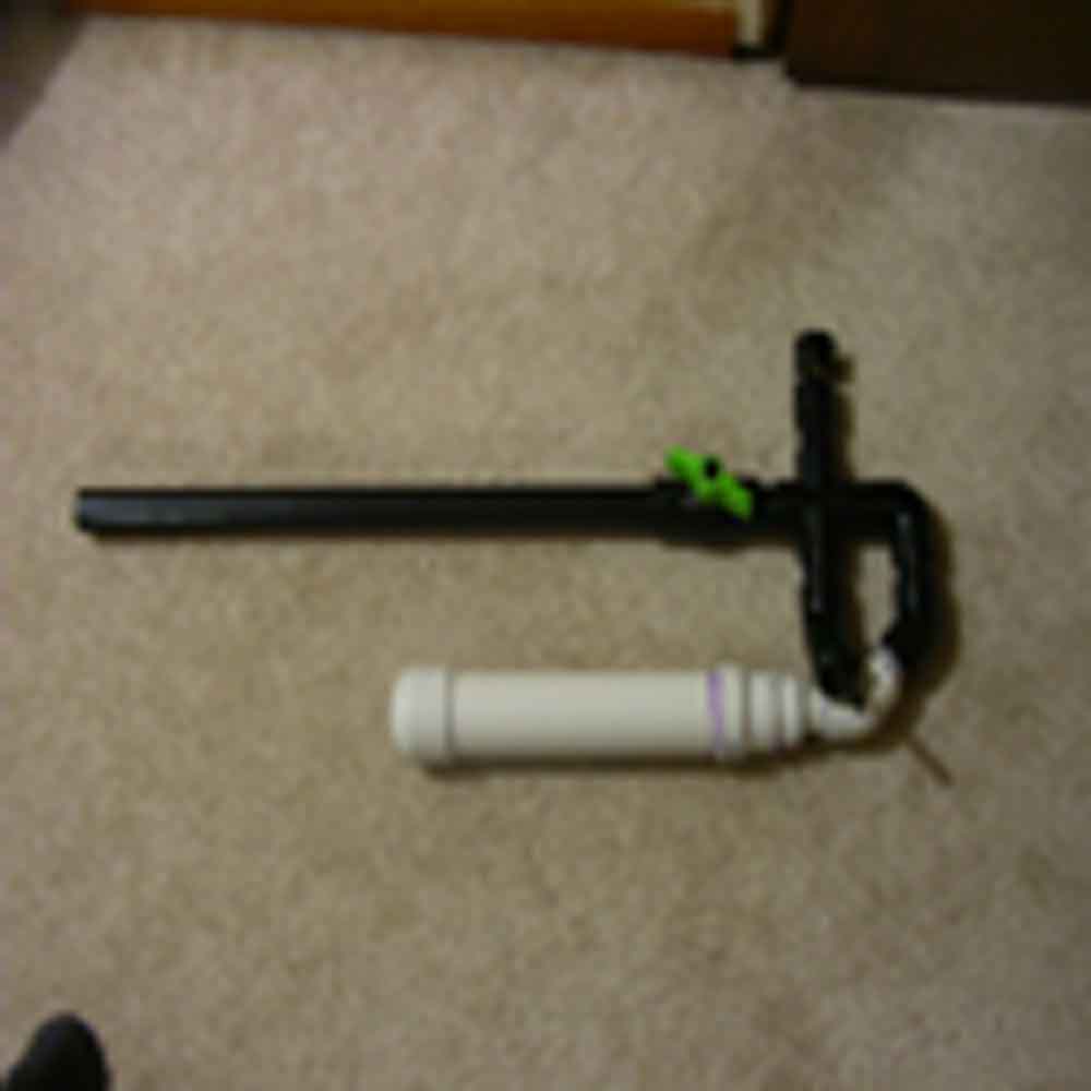

Also I plan on removing the ball valve (cutting it in half with the band saw then using the dremil to get the res of it off :twisted: ) I was considering building a diaphram valve because to use a piston I would have to start all over again, and I have already built several new guns that are worlds better that this. Any ways, Since it is still a decent gun ( at least it will be) I want a better valve and I do not want to use a sprinkler valve. If any one has a good resource for building a diaghram valve it would much be appreciated! (JSR here is your time to shine :D ) I have been searching for about a week and have come up dry every attempt.

Do you have any recent pictures you can show us? Your decision to replace the soda bottle was a high quality one!... at least on concept...:wink:
I know you say you're in the midst of working on it....showing your improvements would be valuable I believe.

Ok, I will add a picture. Any resources about a diaphram valve will be helpful :)
sorry for the low pic quality
