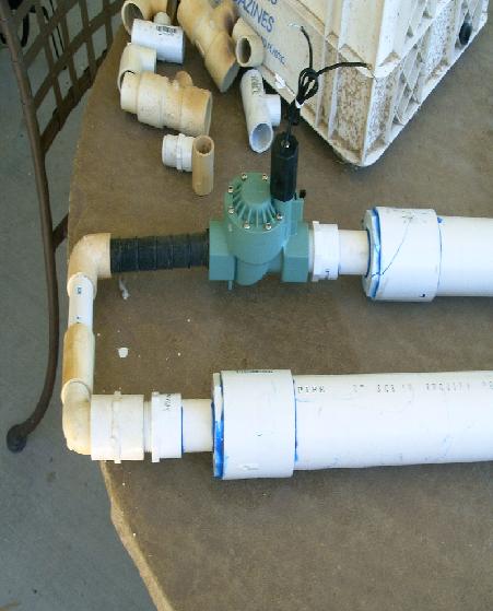

ok here is a pic of my gun i am building. Everything is there except the electronics for the solenoid. It will be an interchangeble barrel. ok so see if it will work like this. one thing i still need to do is put the schrader valve on sumwhere. sorry for the bad quality and small photos. It wouldn't let me upload the original because they were to big.

ok... well u can make a pill box cannon that would fit in ur pocket and shoot q-tips about 20-30ft, they can cost nothing or next to it and my sprinkler pnumatic cost my about $70-$80, a simple combustion would only cost about $10-15 one with just a chamber barrel and igniter, but u can make a ball valve pnumatic for about $20-25, price really depends on what u put on the gun and where u buy the parts from
waht the hell kind of fittings are they? they look yellow, they cant be pressure rated, and i can tell it looks like the coupling and reducers are DWV by the socket depth, what is the black fitting beween the elbow and the valve?
also you should try modding the solenoid valve so you dont need batteries, and it'll give better performance

i think the black thing is jsut pvc wrpaed in black grip tape cuz i think thats his handle

ok those yellow pipes were just really old pipes my dad had in a box. I went to my grandpa's and he had brand new pipes. Everything is much better now i cant take a pic currently but I will soon. Ok "you should try modding the solenoid valve so you dont need batteries, and it'll give better performance" i dont understand how modding it will make it possibly to use no batteries. I think I get it would you always have your compressor hooked up to the blow gun? I dont realy get it. If what I said is true the reason I dont want to mod it because i dont want it always hooked up to the compressor. Please Explain.

ok, u dont need to always have a compressur hooked up for one. second all a electrical part does is open a hole to open the phram(im not goign to explain a phram jsut believe me) and all a blowgun does is open a different hole and blowguns dont need batteries and they open the phram faster then a solinoid
