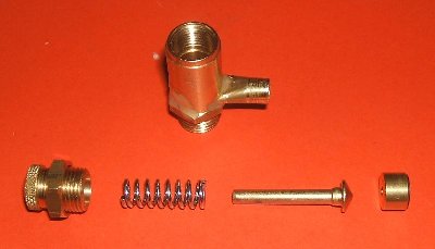

I've long been a proponent of self-made fittings, but recently spotted a couple of adjustable safety valves and decided to buy them for the heck of it to see what they could do. Long story short, I hooked one up to a blowgun attached to my compressor and after tweaking the spring tension a little:
I think it's safe to say you can expect another attempt at an auto project pretty soon :D

It exhausts from two slots, all I need to do is block off one of them and attach the other to a blow-forward breech, given the joys of epoxy casting that shouldn't be too much of a chore :)

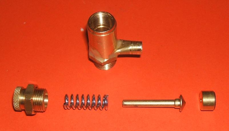

Here's what it's looking like, one port blocked off and a flattened brass tube on the other port to feed into the breech, all that's left is to encase it in epoxy for strength and we should be good for testing in 24 hours :)

The valve was purchased off eBay so is no longer listed, but it's nothing special, works just like any other pop-off only the top is threaded to allow you to adjust the spring tension. alternatively one could buy a standard pop-off with a fixed pressure and change springs.
