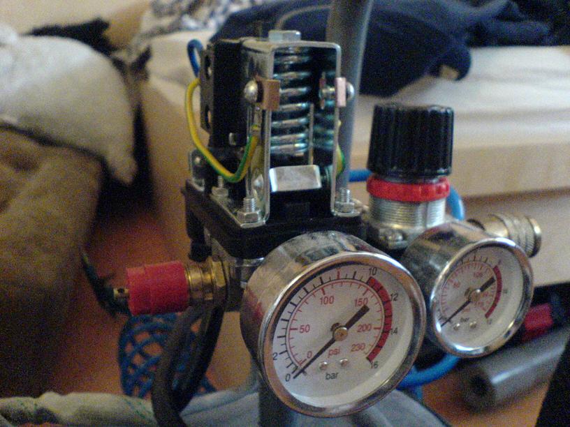

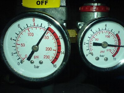

10 Bar! :D
10 Bar! :D

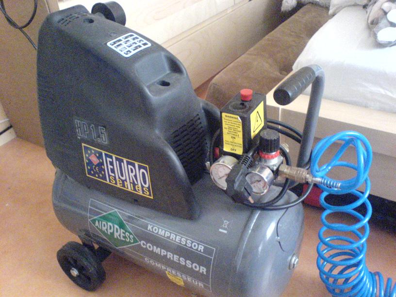

The air compressor in its full glory.<br />The yellow warning label reads:<br />WARNING!<br />Pressure controls set at factory for maximum safe operation. DO NOT ADJUST FACTORY SETTINGS!<br />But lets pretend the label wasnt there. :)
WARNING!

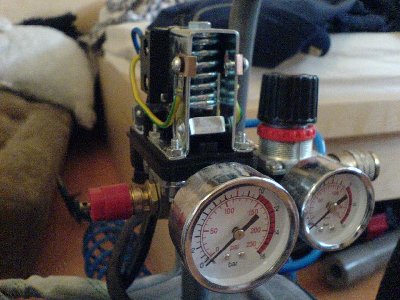

This is what is under the cap with the red button. To the left you can see the popoff valve which I later replaced by a plug.

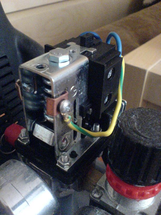

The bolt on top is the magic bolt which determines when it shuts on or off.<br />You can also see the + and -.
The switches that turn the power on and off. These get controlled by the spring, but when pressing in the red button to turn the compressor of (like I do with my finger here) they also open.

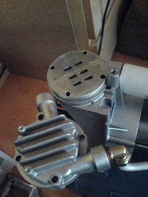

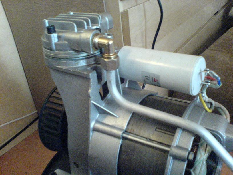

Here you can see the piston housing, electromotor and a capacitor.

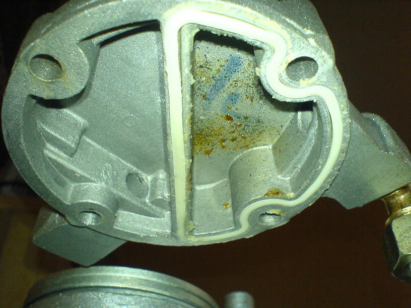

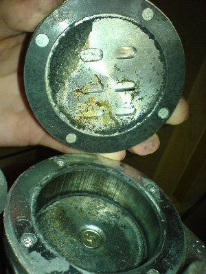

The cap is hollow on the inside.
The check valves. Note that dead volume stops here, so the big empty cap doesnt matter.

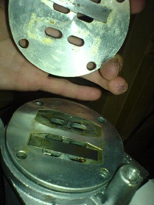

Here you can clearly see that the check valves are just metal strips.
