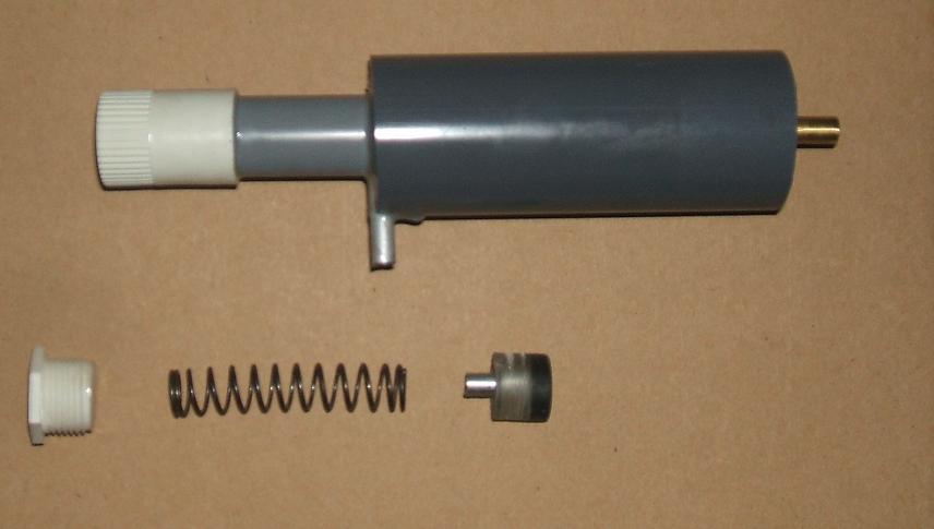

Introducing version 2.0 :)
Replaced the air spring with a coil spring, so the piston isn't 100% airtight but the (yes, psycix) threaded cap is so not a lot of air is wasted, and it's reasonably servicable ;) Seat and piston diameter are reduced compared to my previous prototype, we'll see how it goes tomorrow when it's fully hardened.

psycix
Posts: 3684
Location: The Netherlands
Good luck!
I have a feeling that it will work better without cap.
If you stop air from going out, the pressure on the back side of the piston will rise when air leaks past and especially if it moves back. Result: big force pushing the piston down.
If you are lucky, then this effect is beneficial and helps cycling in some way. If you are unlucky, well, it will not.
Join the threaded side... and then you will rule the empire of serviceability!
