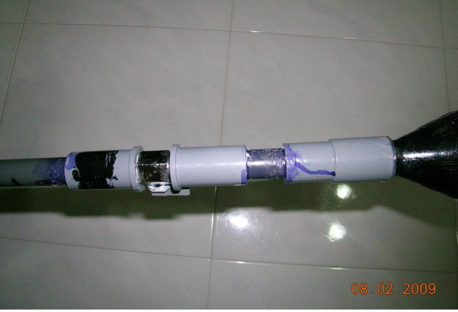

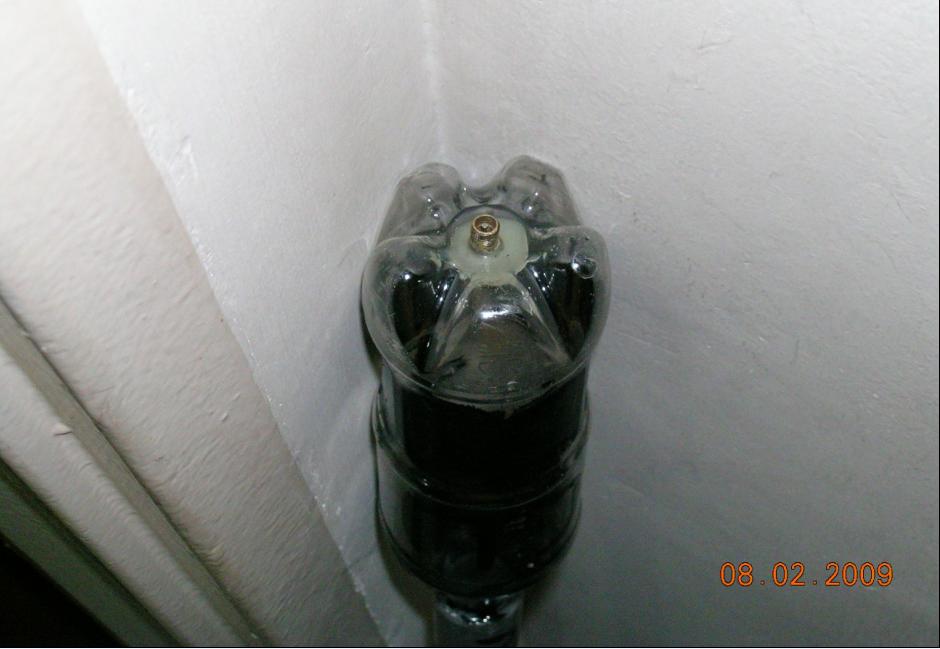

This is a simple chamber - ball valve - barrel gun.
It's purpose is not so much for shooting, but more as a training tool in my science club (which I run).
It is extremely cheap & easy to make. Unit cost is about S$8 per gun (using new build components & after factoring epoxy and PVC primer & cement), while assembly time is around 15 minutes if guns are individually built, and around 10 minutes if they are mass produced by a group of people assembly line style. However, the 3 day epoxy drying time cannot be ignored.
It's purpose is as a fun way to train juniors in construction skills like drilling (which they can later use in research), and research skills like safety & observation. For this, many aspects of these are advantages:
- Simple - easy to teach the skills
- Cheap - can be done on a large scale
- Basic generic design - opportunities for juniors to be creative and modify the design, so long as it is constructed properly (I am supervising)
- Inefficient - opportunities for juniors to think of how to improve
- Dirty - make them get used to it
- Not so ghetto - I can control parts to prevent unauthorised production.
Unauthorised production is dangerous because there is always the risk that someone tries to build one on their own, WITHOUT SUPERVISION, does something stupid and gets spudding banned in the process (this is Singapore........even Australia can't compare in strictness).
Pictures are below. No damage pics as we do not destroy things with them and we have not made enough ballistic gel yet. Videos will be uploaded soon when my firing range (some open ground in school) has nobody around.
Any suggestions or comments about this?
Thanks.
