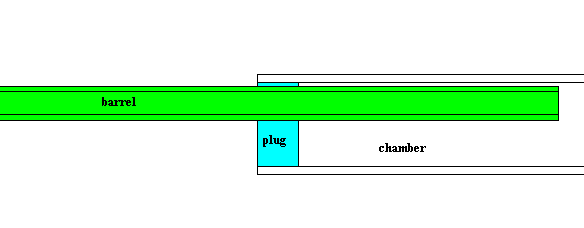

What I am suggesting, metallover, is something like this. Easy to build, but requires some sheet pvc (or alternatively a lot of epoxy). You have plenty of room for spark gaps, and you can even put one or two smaller fans below the barrel.
You can also keep your breech loading without using a wye, which are not pressure rated by the way.
This is the same way my first combustion was constructed, the only difference was I didn't push the barrel in that far.

As far as your coax setup, I like the idea. How difficult is it to get the barrel in straight? Also, how large a fan or fans would fit under the barrel, assuming standard pc fans?
1)I'd recommend using a vice and clamps to get the barrel straight when the glue is drying. If the hole you drilled is nice and clean it'll line itself up.
2)With a 4" chamber and 1.5" barrel you'll have a bit over 2 inches. You can easily get a 50mm cpu fan in there.
You could potentially get 80mm fans in if you mounted them horizontally. A bit trickier but it'll mix the fuel just as good.
