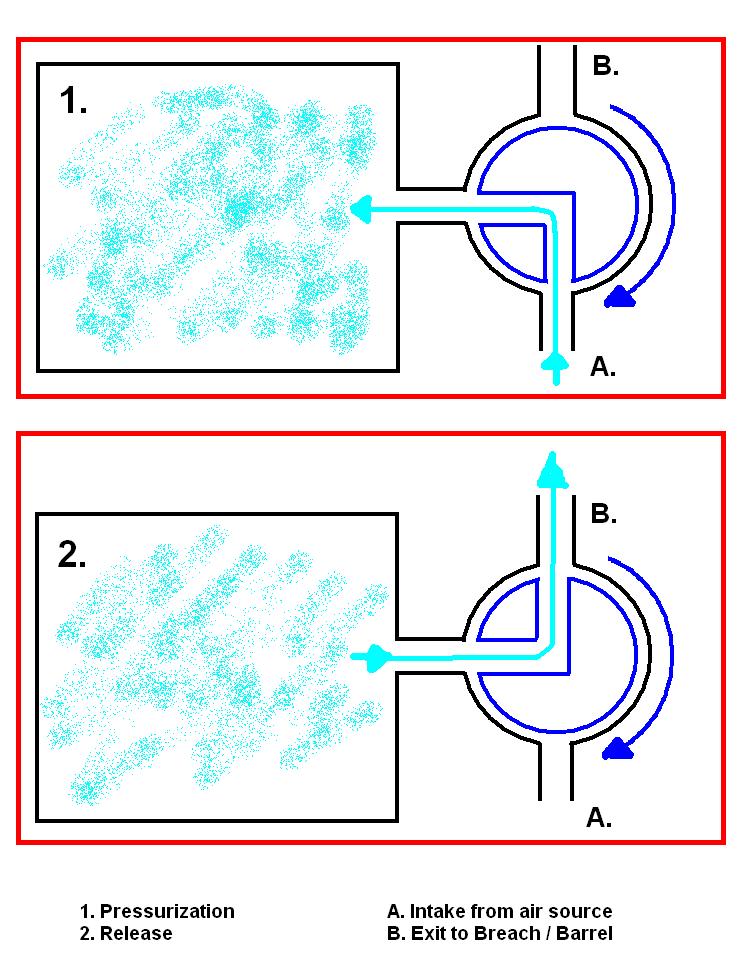

Alright, I'm floating around the idea of making my own airsoft Mini-Gun out of mostly readily available items such as PVC pipe and copper tubing.
I'm trying to figure out all the parts i need, before i set off building anything, and tossing a few ideas around. I'm gonna make the barrels spin and regulate pressurized air-bursts for propulsion using an electric motor, gearing, and a battery.
I'm planning on using pressurized air for both the propulsion of 6mm plastic BB's, and hopefully for ammunition feeding. (right now, im not expecting the prototype to be man-portable, i'll have it connected to a shop compressor and car battery, and set it up on a table or mount).
To control the air bursts for propulsion, i have this idea for a rotary valve with a pressure chamber. The size of this chamber should influence directly how much air, up to a point, will be released upon each pressure-release cycle.
Here's how my idea works. There is a large circular tube, with 3 pipes coming out. Bottom pipe is air intake (A). Left pipe leads to the pressure chamber. Top pipe leads to the barrel, or breach or wherever you desire the air to go (B). The dark blue area is a solid cylinder shape, made of aluminum or something, and fits airtight in the larger tube (obviously not like this illustration, spaced for clarity purposes). The tube is capped off on both sides, with a hole in the middle for a rod attached to the inner cylinder to rotate it in the tube. There are hollow places drilled into the cylinder to create a 90 degree "pipe" through it.
When the pipe aligns with the intake and chamber, the pressure chamber will be pressurized.
When the cylinder is rotated by 90 degrees, the pressure will release out the upper pipe as the "pipe" drilled out of the cylinder aligns with the pressure chamber and the air exit.
The cylinder will rotate 180 degrees more, back to where it started, restarting the cycle.
I imagine the internal parts of this valve would need a bit of lubrication, as to prevent leak-causing parts wearing, and to help seal off leaks.
Does anyone out there think this will work?
If anyone wants to go try this, by all means go right ahead, and tell me the results.

The concept may have some potential, but I think you'll have better success if you have a stepper motor that steps from one position or the other instead of just "flying by" in an unstopping rotation. I could see potentially using an RC servo motor.

Yeah, but i want the release of air to be exactly synchronized with the rotation of the barrel, and i figure using the existing motor will make it easier. Using another motor would be quite difficult to time with the rotation of the main motor, so i figured just run a gear box to get 6 releases of the valve for every turn of the barrel carriage. (6 barrels)The concept may have some potential, but I think you'll have better success if you have a stepper motor that steps from one position or the other instead of just "flying by" in an unstopping rotation. I could see potentially using an RC servo motor.

inonickname, i think i understand your concept there. There's as many holes in your rotating piece of tubing as there are barrels, which align to one hole in the inner tube, which the top barrel will fire when the holes align. Looks far more efficient then my idea. I'll study that design a bit more.
