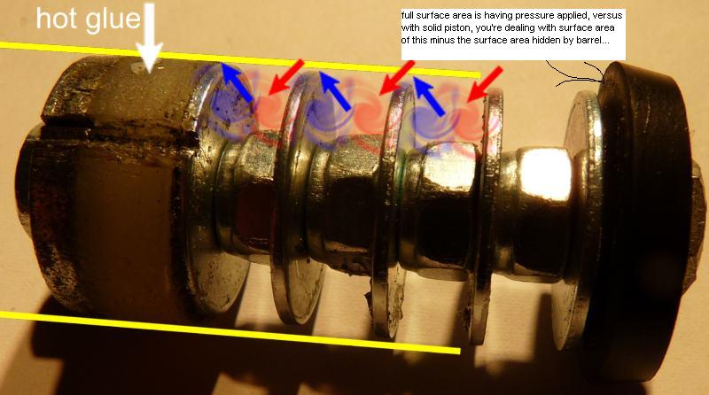

Well, I am new at this forum but I visit this side for quite a while on the search for new ideas and designs.
I read a lot about piston valves and the importance of surface in this issue. So one day I asked myself; if surface is so important than why not providing surface to a piston?
In the beginning I started with "Full Body Pistons" made of hot glue. They are easy to make, solid and reliable. The Problem is that you need a certain amount of negative pressure (if the barrel is not significant smaller than the piston) to make the piston hit back.
So I came up with the idea to build a piston that provides "Multi Surface Sections".
The results are astonishing:
The hot glue piston need a 1/2" ball valve to work.
The metal piston works with a simple blow gun (with better performance).
The "Multi Surface Piston" hits back faster than the air is able to exhaust from the pilot blow gun (it's like an air bumper).
I don't claim that this concept works the way I described (because I don't have a real scientific evidence) but the results speak for themselves.

Um... afraid not. Bear in mind, pressure acts on all surfaces equally - the force on the front surface of those washers is countered by the pressure on the other side. Only the pressure differences between the front surface and rear surface can possibly count.
If it opens any more efficiently, the extra surfaces have nothing to do with it. It is however possible that you have lightened the piston, which might account for it's improvement (although given that's mostly steel you've replaced it with, I doubt it)- or possibly simply created one that fits better.
It's nothing to do with the extra surfaces.
EDIT: We've actually had something similar around for a while, anyway - generally known as "bolt pistons" - here's one I was half way through making.
It cuts weight over a solid piston, and is pretty simple to make - it also allows adding of bumper springs and rubber washers which can be configured like a check valve. Not uncommon on small-ish piston valves.

Of course you are right. When I said "one day I had the idea" I meant a really long time ago when I was dumber about this subject (reading educates :wink:).
The metal piston is actually heavier than the hot glue piston and the fit is compareable.
Hypothesis:
The hot glue part at the end has a bigger diameter than the washers (piston housing: 21mm I.D. Washers: 20mm). My suggestion is that the air, when you open the pilot, interfere between the washers and "grab" the piston.

MRR wrote:My suggestion is that the air, when you open the pilot, interfere between the washers and "grab" the piston.
Although to a minor extent an effect like that might be exhibited (indeed, that is much what the wind does, converting flow speed to pressure), the air flow required to make a significant difference would be so much that you'd be wasting most of your air on opening the piston - nor would a blowgun be up to providing those flows.
Indeed, in some rare circumstances, it might make a small difference to opening time to allow air flow in such manner, but would actually ruin efficiency to do it, and it would require a much larger pilot valve.

I was thinking here and, I don't think The would work because of what rag said. I thought of that before I saw rag's post. But I think The OD of the barrel compared to the diameter of the piston has some kind of effect like popoffs. Think, the gun is fully charged and the olny force pushing the piston onto the barrel is airpressure duh but the pressure is olny working on the cross sectional surface area of the barrel but on the back of the piston the other surfaces cancel each other out hard to imagine. But when the gun is piloted the pressure has to drop enough to make the piston come away from the barrel due to the negative pressure but what happens when the piston comes away from the barrel? The equal ammount of surface area the end of the barrel has is revealed on the front of the piston sort of like a pop off maybe that is why piston valves open so fast. Like pop offs. BTW what's with the large equilization holes?

When the pressure between the washers is equalized on a pressurized gun and you open the pilot, isn't it possible that the gaps give an advantage when the piston is pulled into the direction of the lowest resistance?

that would explain why the stacked washer setup beats the solid piston, with the solid piston you are dealing with not enough surface area being acted upon by the chamber pressure to unseat the piston from the barrel...
copied from my other post...
edit: I know most on here know this but for any noobs I'll post it. This is for any solid/non-toolie piston valve.
the force sealing the barrel is pressure times the surface area equal to what is exposed to atmosphere via the barrel.
the force (with pilot opened) that is trying to move the piston backwards/open is the pressure times the total surface area minus the surface area hidden from the chamber pressure by the barrel outer diameter.
if the first number is higher than the second, the piston will not move, or if they are very close numerically the piston will not move quickly...
