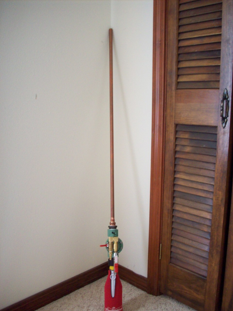

I was bored about a week ago and set out to build this. It was a really bad decision because it delayed the serious pneumatic project I'm working on at the moment, and cut into my funds, but oh well.
SPECIFICATIONS
  • Dr. Pepper bottle air chamber
  • Pneumatically actuated sprinkler valve
  • 1/2" x 36" type M copper barrel
Here it is in the only clean corner of the room.

Why put a copper barrel on it? when you could have put a PVC one for a total of about 2$ :D that would be one way to save money.
Posts: 3643
Been thanked: 62 times
Becuase copper looks cooler? :)
Also, I like the ID of 1/2" type M copper. It's a perfect fit for marbles, and other things...

Ah you used your bottle adapter thing. :D
Sprinkler valve pilot looks neat.
Do you see vapor forming in the chamber when you fire it?

I've only shot it with the chamber sleeve off a handful of times, but I see it sometimes when it's sunny out.
