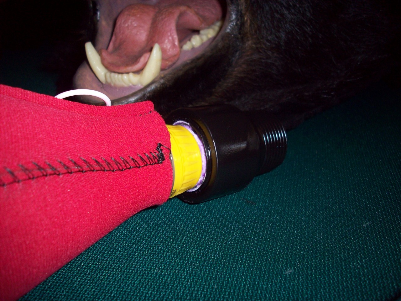

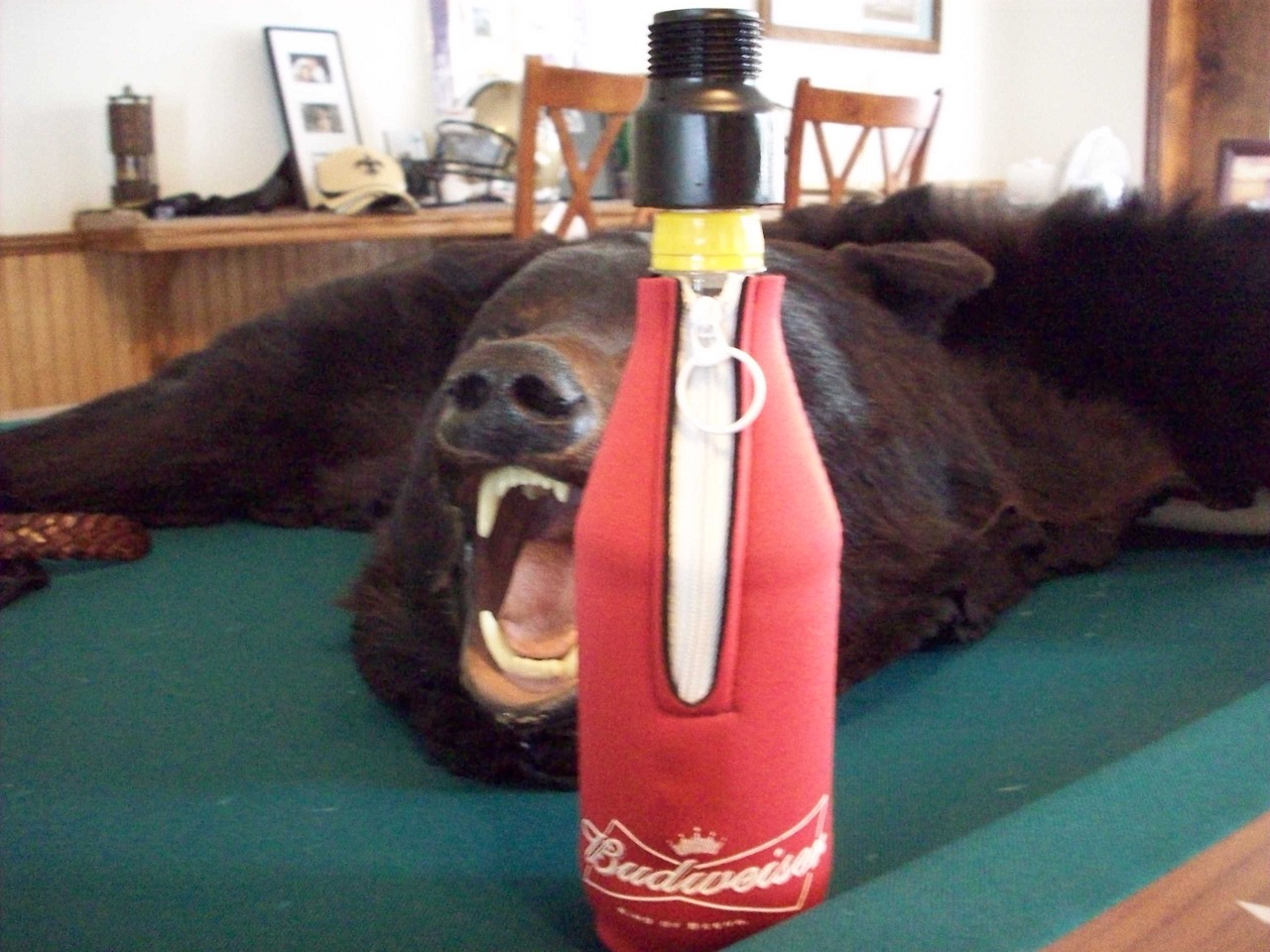

Well, I finally built a prototype (the actual cannon it's going on is almost done as well).
I think what you guys don't realize is that, yeah, a PVC chamber is just as cheap, but sometimes it's fun to try new things and experiment. I made a combustion out of a JIF peanut butter jar and it wound up costing me more than a comparable sized PVC spudgun, but I was fine with that because, well, it was a freaking peanut butter jar and a piece of a 2 liter bottle....
Anyways, enough blabbing, on to pictures.
Pretty sexy, eh?
Pretty sexy, eh?
I painted the PVC black because I goofed up masking off the fitting when gluing, so I wound up with primer stains where the ribs on the fitting were.

That budweiser bottle sleeve looks funnny on it.
Though the clear plastic is just the one thing in which soda bottles are superior to pvc: you can look at the combustion flames and sparks on a combustion or water vapour on a pneumatic.
Yes, I know clear PVC exists but that is very expensive for most of us.
