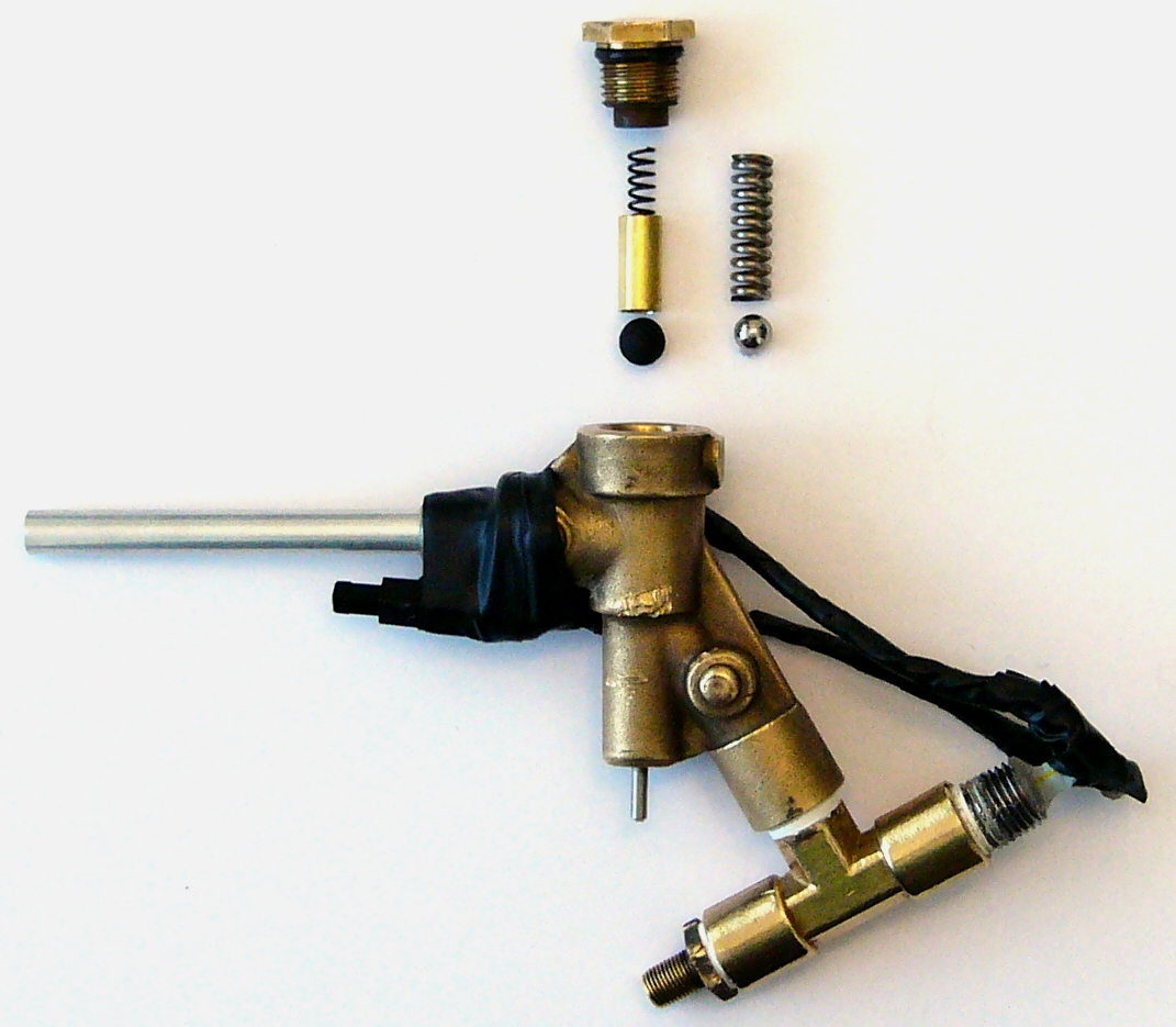

Valve - modified pressure washer valve
Chamber - ~.25" x 3.5"
Barrel - 6mm x 3.5"
Ignition - lighter piezo
Mix - 1-4x
Ammo - 6mm .12gm bb's
The valve is run backward from its normal application. The spring and sealing face I replaced. The rubber ball is from a check valve in a bike pump.
The small size and low pressure is because I am testing this inside. I built it as a prototype to test the valve. And it works! :)
Damage sucks because of the huge dead space relative to the chamber and barrel, as well as the opening pressure. It opens at around 50 psi. But I can't crank that up because I don't have an appropriate place to test it at the moment.
Hopefully that will change soon and we can see what it'll do at 25x :D :shock:. (Will upgrade brass tee to steel and point spark plug in other direction first)
Edit: Tried to see what pressure the original spring would open at with a shock pump and the valve seat popped out at 200 psi. I didn't realize it was a separate peice :?. Back to the drawing board.

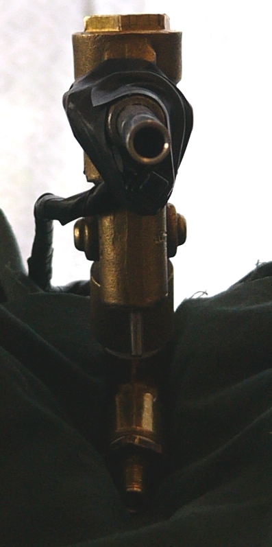

I solved the problem of the seat coming out by making a sleeve that presses it in when the plug is screwed in. Took some trial and error to get the length right. The upper o-ring acts as a tensioner.
However, this creates a new problem of not enough flow around the ball. So I have to find something smaller about the size of the original ball, as pictured. Tried one of the airsoft bb's, but it wouldn't seal.
Also made a pill bottle suppressor which will hopefully bring the noise level down to an acceptable level. So far I've only fired it with a bundle of rags wrapped around the cannon and target. It's filled with a spiral steel dish scrubber, which may be too coarse to suck the heat out fast enough. But the only other thing I have is extra fine steel wool which would just light on fire I think.

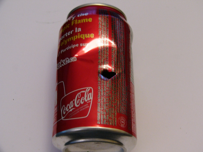

And damage pics below. The shot in the side of the can wasn't on film, but you can see the entry and exit holes. The shot in the bottom was the one in the first clip. It almost penetrated, leaving a flap bent in a bit.
Anyone know what that means approximately for velocity from airsoft experience? I don't know how to model this thing in HGDT.
I don't know how much effect the suppressor is having, because I haven't actually fired it without or without a suppressor made of a pile of rags. The videos don't do the volume justice and I don't want to take off the suppressor to find out it was actually working quite well! As I am at the limit of what I can test inside.
