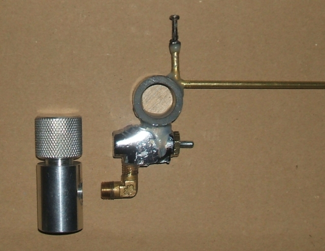

Update on this idea, I'm making a variation to be used with my paintball tank. Basically a small BB chamber (about 120 3mm BBs capacity) connected on one end to a heavily chopped blowgun and on the other a 15 inch 3mm barrel with a sprung detent to limit firing pressure tp the 500-800 psi range. Here's the core of the setup before I bury it in an epoxy casting:
