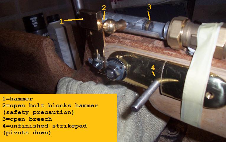

Well...here's a proof of concept gun from your friendly forum BTB...
I had to do something to show Psy is not the only Dutchman on top... :D
A QEV gun, 1" reservoir, hammervalve actuated so it's repeating.
http://eurospudguns.forumsdot.com/downl ... .php?id=49

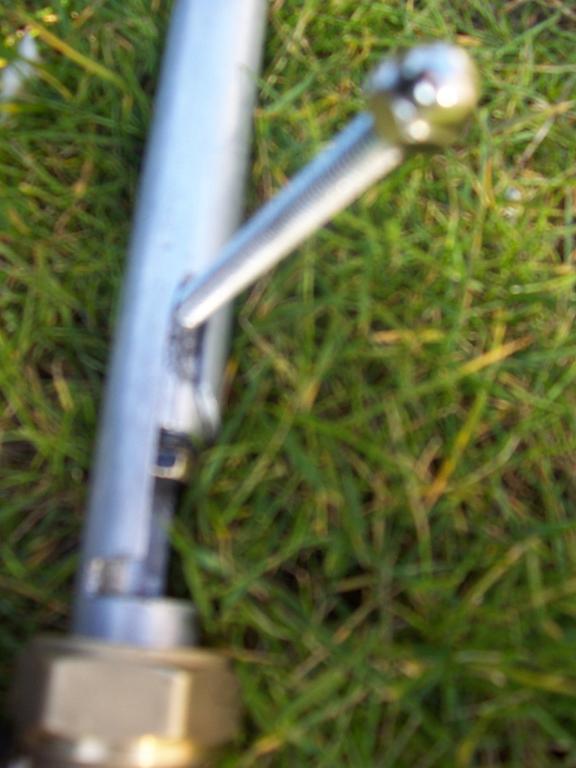

The bolt action is a little different, because it feeds through a T, wich enables me to use a solid bolt, the same diameter as the ammo.
Just one opening to seal...
http://eurospudguns.forumsdot.com/downl ... .php?id=50
A magazine will be fitted later, wich will feed ammo to the bolt.
A hammer will also be fitted, wich wil be cocked by pulling back the bolt.
The bolt is solid as I mentioned, so itenabled me to tap a handle into it, not just for looks, but because this construction is stronger.
An O-rong seals it.
I get 5-6 shots out of the reservoir at 20 bar.
I mean to fill it to 45 though, so a heavy hammer will be needed.
The backpart of the bolt makes it easy to attach a hardwood handcarved stock later...
All of you can use this design, just be sure the bolt , when closed, is strong enough to take the blow.It;s gonna be next to your face.

question... I'm assuming the barrel goes back into the tee a bit...but how does air get into the barrel if the o-ring seals the bolt and it is solid...
I'm kinda tired now so I'm not really thinking straight... thanks for being patient
EDIT: Does the air flow around the smaller diameter nut on the front of the bolt? I'm assuming thats what it is
Lentamentalisk
Posts: 1202
Location: Berkeley C.A.
The ammo is loaded from the back, pushed in by the bolt. The bold doesn't go into the barrel, it merely pushes the ammo into the barrel.
Netherlands
Posts: 3497
The bolt is plugged with a 1/4" plug.
It pushes the marble until it sits on top of the valveport.
The barrel and bolthousing are one piece.

what bore is it? because i would have thought the ammo might slip down toward the valve?
(and have you got a full length pic?)
Netherlands
Posts: 3497
As the ( edit: original) topic title suggests, it's marble caliber, 16mm.
In the original post you'll find 2 links to pictures I can;t seem to embed.
Click 'em.One is a full length picture.
Edit:
Woopsy...No it's not
Here is the link now
http://eurospudguns.forumsdot.com/downl ... .php?id=48
