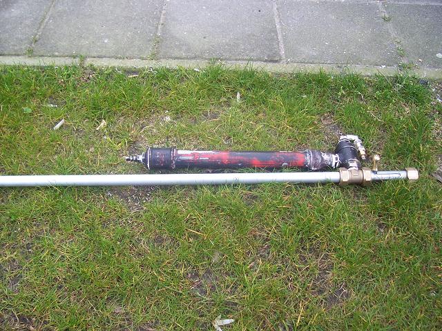

Very nice looking there, I must say. How many shots are you intending to get out of a single charge?
- Brian the brain
- Posts: 3497
- Location: Holland
- Been thanked: 7 times
You can all see the tiny chamber..I get around 6 GOOD shots out of it.
I'm threading a chamber twice the length.(edit: full length chamber is now in place)
I intend to get around 10 shots minimum.
There is no real style.I'm gathering parts that will all " work" nicely together,
The theme will be a little different...
I plan on using a lot of brass for looks, hardwood for the stock and all steelparts will become flat black.Something that seems to be from the 1800's.
A tribute to the past...

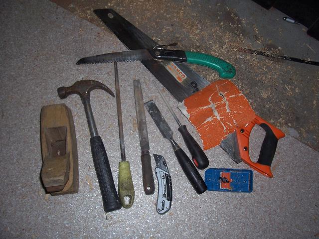

Double post, just so I can add some relevant pictures...
Remember...this is far from finished.

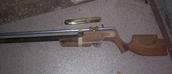

firstly I would like to say, excellent gun! secondly what struck me when I saw the picture you posted is that it looks like -with the heavy weight of the gun - the stock would snap very easily IMHO. also I would like to comment on how quickly you managed to make that stock, when I made mine it took a couple of weeks and doesn't look much better than yours!

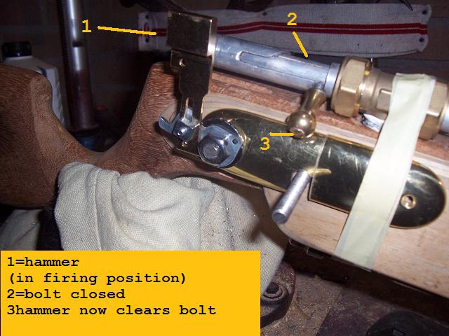

Scope and rifled barrel will be the last things I will add.
I need to finish the stock.It will have the wood extended to the front, a grip if you will.
It will have brass sideplates to connect and firmly attach all the wood pieces and after that ( @ cheeseboy) it will be strong enough.
So yes..at the moment it would snap.I just took the picture as soon as I had something of an assembly to show.It's not near finished as I mentioned earlier
Then I will work on the exterior hammer (
that's why you can't find it now) and the interior lock for it.It will be placed on the right side like a flintlock hammer.This is purely because of the theme.I could make a hammer anywhere, but it's 1800's I'm going for.

wow it looks great...
one question.... is that cheek rest (is it the right word?? oh whatever I mean the thing where your cheek rest when you aim) high enough ??
- Brian the brain
- Posts: 3497
- Location: Holland
Haha, so it's down to knitpicking now?
No it's perfect.For me anyways, as I'm a cheeky kind of fellow..
So, more pictures of the progress.
I've decided to name the gun Brass T-Bolt
Yes...BTB...why not?
