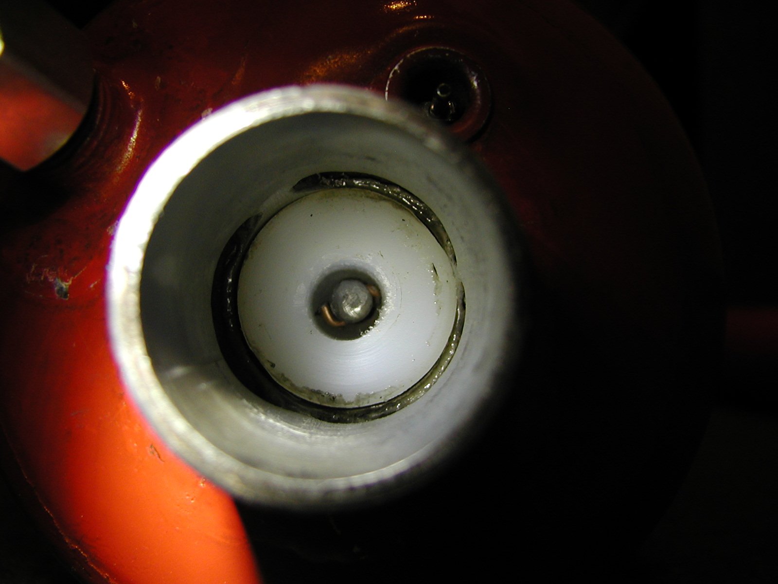

If the valve turbulence limits flow speed to about supersonic, then a 4X area increase (2X diameter) from the valve to the barrel limits the speed in barrel to 1/4 supersonic not counting gas expansion. On my Quick dump valve cannons for fruit and the 2 inch valve I get fantastic performance on the 2 inch and 2.5 inch barrels. On the 1 inch valve, attaching a 1 inch or 1.25 inch barrel provides good results.
On the 1 inch valve I am not considering any larger diameter barrels except for a antenna launcher shooting tennis balls. Extreme power is not needed to toss a tennis ball over a tree.
Here is a view into the valve on the 1 inch launcher with the valve open. The ports have a larger cross sectional area than the pipe diameter. The valve ports are directly inside the pressure chamber.
