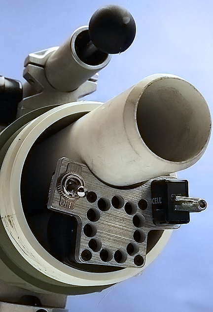

The thought is to create a step in the barrel to restrict the potato until pressure has built up.
I was thinking to turn out a piece of schedule 80 2" so that the ID was same as OD on 1.5" schedule 40.
Specific to our breach loading BL-415 I was going to remove 3 of the 4 inches that the barrel sticks out of the back of our BL-415. Then, slide/glue on 4 inches of the turned 2". The 2" would be sharpened to cut the potatoes which will now slide in and be restricted by the step where the 2" and 1.5" meet. The restriction should allow pressure to build before the potato is re-cut to meet the ID of the 1.5 upon exit.
Thoughts? Will the potato stay intact? Pressure build up be to great and chamber failure?

If I'm not mistaken, I could be, 1.5" sch 40 already fits inside 2" sch. 80. I wouldn't bother with remote test firing if all your parts are pressure rated. Most combustions will produce under 100psi. As long as the 1.5"pipe is sharpened also, the potato should stay intact.

lctchamp wrote:If I'm not mistaken, I could be, 1.5" sch 40 already fits inside 2" sch. 80. I wouldn't bother with remote test firing if all your parts are pressure rated. Most combustions will produce under 100psi. As long as the 1.5"pipe is sharpened also, the potato should stay intact.
I was thinking not to sharpen, keep flat for more restriction.
http://www.engineeringtoolbox.com/pvc-c ... d_795.html
Looks like its .039" larger. Like stated, should work without modification.
That may work the only way to find out is to try it. I used to not have my barrel sharpened and would just smash the potato into the barrel. It worked with decent performance, but the potato would sometimes split which would allow air to pass by. It might turn out similar.

you dont even need a sch 80 tee, all you need a a small peice of sch 80 for the guide tube because sch 80 and sch 40 and fit in either fitting
i also think that the potato may crack/turn to vapor when it tryies to go into the smaller pipe

In a pneumatic, anything that delays projectile motion in the breech can only be a good thing as long as no gas blows past the projectile. In combustions though, if the projectle stays still too long, the burning gasses lose heat and therefore pressure and you could therefore lose power.

The thing is, as jack said, the pressure created in combustion is only held for a split second then dissipates. You would have to be able to control how long the projectile is delayed by the shift in bore size. This would require a lot of experimenting. Burst disks on the other hand would be a much simpler solution. Good luck anyways if you go for it.
The problem with burst disks is it makes the loading process a lot longer. With the design he has now there wouldn't be anything added to the loading process. I doubt his customers would like the idea of unscrewing a union or undoing a camlock and then having to cut the disks from foil.
