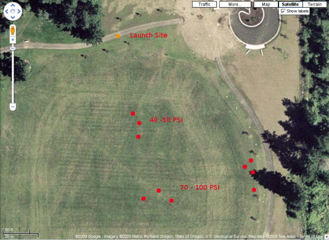

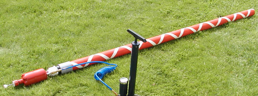

Just for grins I built a tennis ball barrel for my marshmallow cannon out of 160 PSI 2.5 inch PVC 36 inches long for a compact attempt at a silent antenna launcher. The theory was if I take the 54 cu in tank and use about 3 bar, it would expand to the barrel volume of 140 cu in without a loud report. On the contrary, it is very noisy. Am I missing something? In testing a 30 PSI launch fails to exit the barrel and a 40 PSI shot is good for 75-150 feet. 70-100 PSI shots all land in about the same area at about 300 feet with a range difference of only 30-50 feet. 60 PSI shots are not too bad, but 100 PSI shots sound like gunfire with a sharp report.
The small chamber makes a very good use of the air for easy hand pumped launches.
I used Google maps for range checking. The longer shots were oriented off the 3 tall trees casting long shadows in the lower right of the screenshot.

Any thoughts why this isn't quiet like a larger cannon?

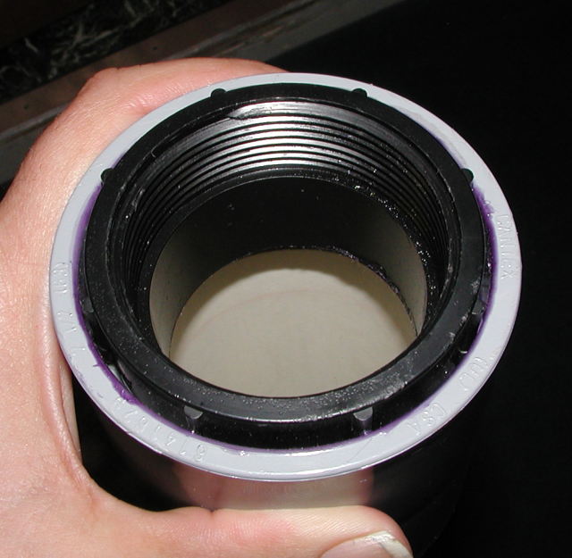

The barrel has a 2.5 inch coupler with a 2 inch ABS female ABS adapter inside a modified coupler. This permitted recessing the cleanout for additional strength. The 2 inch threaded is the standard used for the larger launcher for it's 2 inch threaded outlet. A cement made for ABS/PVC was used to join them.
Added a photo of the ABS female adapter in the barrel. It was part of the effort to keep the distance from the valve to the shirt very short in the competition. It worked well.
Failed attempt at a silent TB launcher

- Marshmallow cannon with the Tennis Ball barrel
The valve is inside the chamber. - Tennis ball barrel1.jpg (36.58 KiB) Viewed 11484 times
