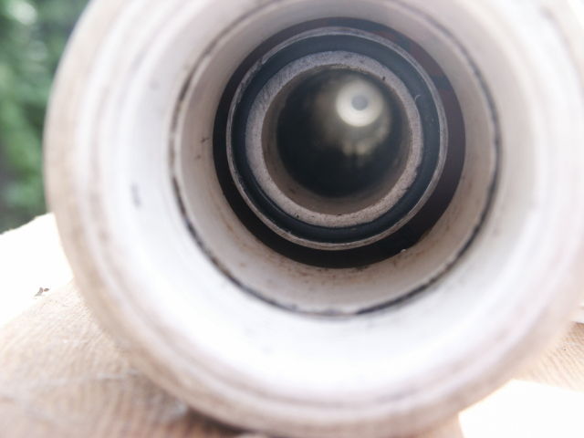

I put this here for those who want to make their own larger QEV valves. The dimensions on this valve make it a QEV.
Here are a couple photos showing the replacement of a cracked 1 inch PVC pipe cap used as a piston in a 1 inch coaxial. This cannon is now retired as it was dropped once too many times. The other end of the chamber cracked the coupler and 2 inch to 1 inch reducer. :( This is now retired. I know :!: FAIL :!:
Valve cylinder and seat seal.  The large seat makes this a QEV as the piston diameter to seat diameter is a low ratio.
Piston in place in the new home.  Cylinder is 1.5 inch pipe inside a female 1.5 threaded adapter.  Assembly is swedged in the end of 2 inch pipe.  It's ready for the bumper and plug with the trigger.
