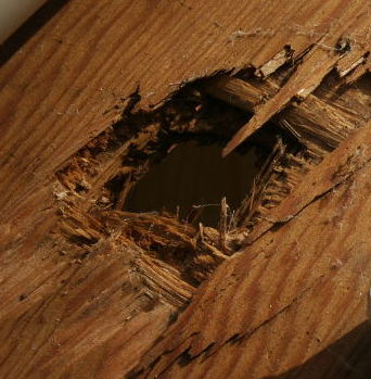

Gumballs shatter too, but it surprised me when one went through a sheet of 1/2 inch plywood. With enough power, he might make it.covey12 wrote:well i know its not a bb, but i have gotten a lead pellet to go through 1/2in. plywood all the time with my 1000fps bb gun, and 1/8 steel too, aluminum i have only tested up to 15 coke cans and it went through all of them, so maybe a pellet gun would work better, by the way plastic bbs shatter when they go fast and hit something hard, just take a regular airsoft gun and shoot the ground point blank, so i doubt you could get them through plywood
Edit*** Added photo of the 1 inch coaxial cannon that shoots gumballs through the plywood. Blow gun trigger is used on another project. This cannon is retired as it was dropped once too many times and the muzzle coupler and reducer cracked and leaks. This cannon broke 3 pistons.
- Hole in 1/2 plywood from a gumball.
- Gumball hole.jpg (37.4 KiB) Viewed 3319 times
