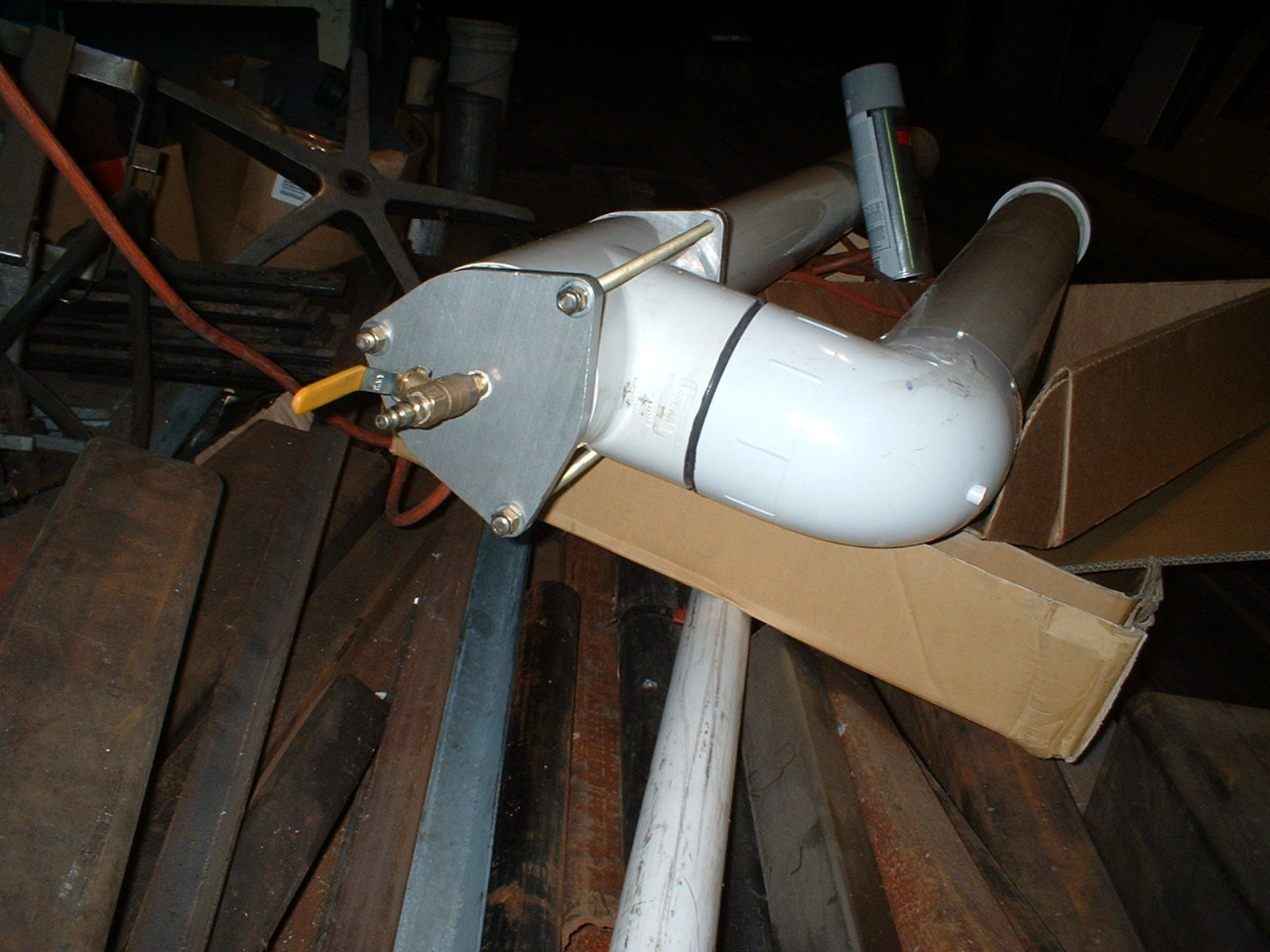

as promised, i went to my uncle's place, and i return with pictures. sorry, you guys got to wait until next week for a video, there was too much going on this week. the design is a fairly simple barrel sealer, with a slightly less simple support system. the plates on the ends of the 4" T are connected by threaded rod to make the piston serviceable, and the barrel interchangeable (right now i have a 3" barrel on there, i plan for a TB and GB one later) the [piston is made out of 2 pieces of solid PVC connected by a 2" PVC pipe. there is a built in check valve. pilot is a 1/4" ball valve, im sure ill upgrade to a sprinkler or QEV eventually. we shot it using the forklift as a shooting stand, and it rocks the forklift a bit. and did i mention that it is my first pneumatic? enjoy.

the cannon.  theres a spray paint can for size refrence

Looks great! Big, powerful and well built! What pressures you running it at?

Wow, this cannon is going to be a monster :twisted: . Good idea with the cone on the piston, It dose increase flow substantially over a flat piston face. Well Done :D

Nice! Great machining you did there.
I love the endplates clamping onto the T piece. Thats a great method to have an airtight and secure way to have a serviceable joint.

Wow, that's a unique way to hold the valve together. Also removes some of the design constrictions when simply threading machine screws through the back of the tee and through the <strike>read</strike> rear plug. I like it!
