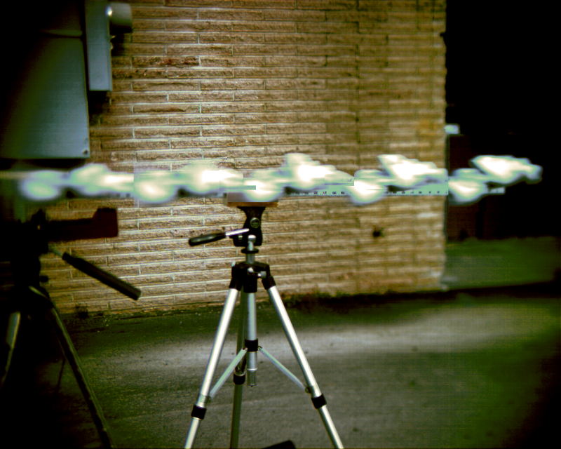

Using a muzzle brake, compensator, silencer, suppressor, or anything to reduce muzzle blast does affect accuracy. Even chamber size to barrel size so the blast is reduced make a difference.POLAND_SPUD wrote:well if I may add something...
...a suppressor won't make accuracy worse.. in fact it will improve it as it greatly reduces muzzle blast which might affect projectile stability after leaving the barrel
Attached is an early composite photo of a high speed t shirt launch where muzzle blast and a corner of the t shirt being loose cause a very early tumble.
Fixing our muzzle blast with a muzzle brake and modifying our shirt roll improved the range and accuracy.
