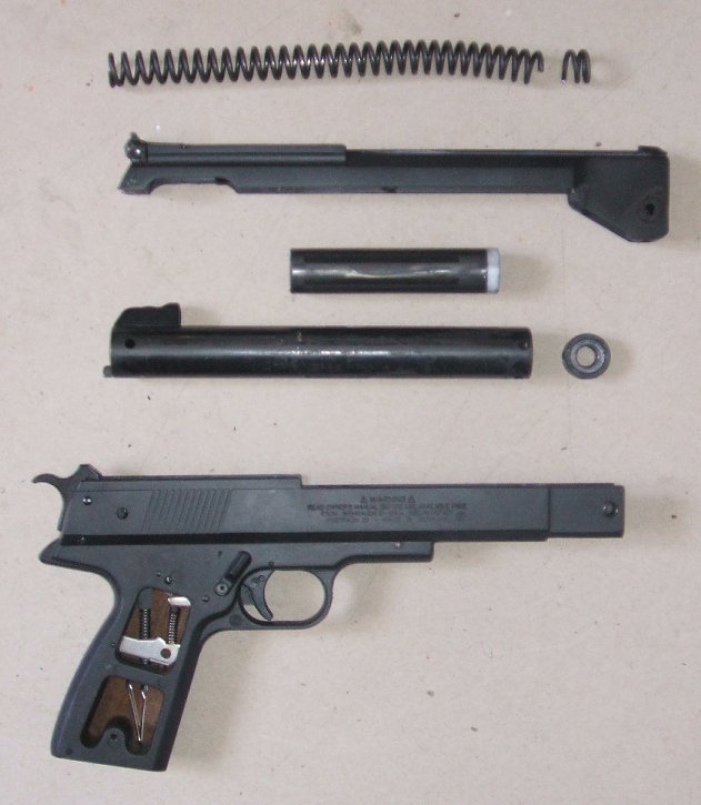

I have one of these, recently I had to change the spring and it was quite a chore. As you can see from the attached pics it's a massive affair and with lots of preload, if fact there's no way you could preload it manually by pulling, let alone cock it - this is why most springers use some sort of lever mechanism.
Even with all this stored energy, it only manages 4.5 ft/lbs of muzzle energy. This is equivalent to chucking a 100 gram slug of potato at a mere 35 feet per second, something which even the most basic combustion will achieve with no effort whatsoever.
You can imagine therefore what sort of power you'll get for something which can be cocked manually. Well, of course you can. Airsoft pistols ;)
