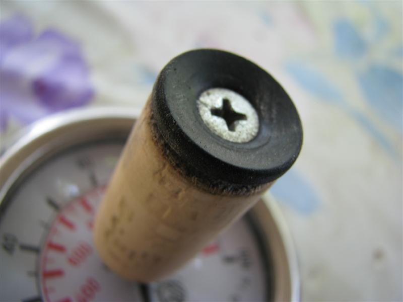

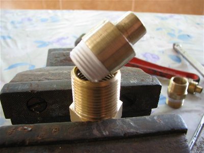

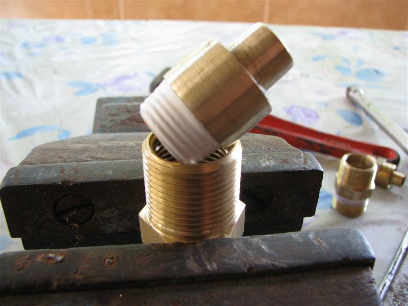

at last i build a piston valve and he work great
it's 3/4" T copper (or bras !!)
the piston made from wood , sweeper stick :D turn it on a lathe and he is about 18mm
and here is the video hoe fast he dump the air. the pressure is about 130 psi
dont forget to watch the video in HD .you know how :roll: :roll: :roll:

the piston
the piston

Congratulations on getting it right so it pops open. Nice home built QEV.

Very nice job Far Cry. :)
You may have some trouble with the sealing face being retained at higher pressures, but only time (and pressure) will tell for sure.
You did a nice job rounding the piston seat too. :D

Your Piston looks friggin' beautiful lol. It' looks so cleanly built.
Nioce Job.

Gorgeous!
Could probably cut down on Pilot volume in the back, And use a smaller Ball valve, But otherwise I'm Envious.
Whatcha gonna put it on?

and what you did mean by You may have some trouble with the sealing face being retained at higher pressures
so may i have some leaks or the seal face stuck ? if so what i can do,, and the piston is temporary from wood .i will turn one from hard plastic or aluminium

[quote="Gippeto"]You may have some trouble with the sealing face being retained at higher pressures quote]
What I mean;
With my bbgun, the teflon seat was "sucked" right out of the hole it was pressed into. This would seem to demonstrate that the flow creates a vacuum at the front of the piston.
Your sealing face "may" be pulled over the head of the screw by the flow.
If this does present itself as a problem, you could turn a washer from teflon or some other softer plastic (hdpe?) to use as the sealing face.
Harder sealing surfaces take more work to be successful, but also yield some small improvements in performance. :D
The screw should then be entirely adequate.(This was the case with my bbgun.) :D

i understand , the seal face will sucked into the barrel with high pressure because the strong vacuum
i will find solution after all
and , can this piston valve handle 1000 psi ? agnor the seal face issue

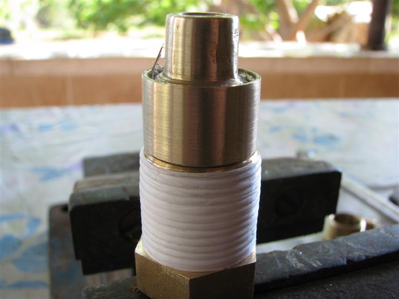

and i have alittle problem the long part ,seat face i put allot of teflon but he still leak what can i do

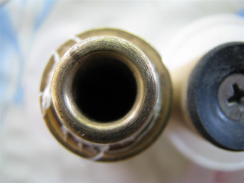

the leak is here what can i do ?

If you have access to a product called "Loctite", the blue variety should provide a seal.
Clean off the teflon tape, apply the loctite and tighten the pieces together.
Then leave it for a day or so. It'll seal.
