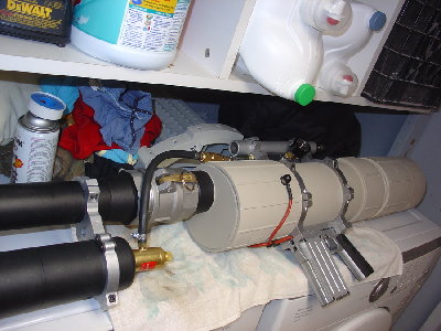

This is how long some of the coax's and even over under cannons chambers look. The reason i am asking this question is that i want to build a coax with a decent chamber length so that it holds like a rocket launcher. a coax with a 8 inch chamber length (ideal) does not hold right. Are all these long chambered cannons sacrificing power for length or is there something else? Are the ratio's right?

Does the fan assembly in the bl-520 take up much volume? I plan on making this cannon.
But the fan assembly on the bl-520 looks like this.
I hope to understand this as i dont have a clue about my ratio problem. Maybe i could internally partition off the chamber so a 20" chamber would act like a 8" chamber.
"The object of war is not to die for your country but to make the other bastard die for his" General S Patton

Joe,
Internally our chamber runs a total of 22". With deductions of barrel and vent piping, fan, etc our chamber ends up at 298 cubic inches. Barrel length measures 62 before brake openings and equates to 195 cubic inches. So we are at 1.5 chamber to 1 barrel ratio. All of our assembled 520's come with take down barrel assembly, so longer barrels / GB barrels and lower C:B ratios are a swap away.
We have found our customers prefer this ratio due to report.
Make sure to run your vent tube to the bottom to help evacuate the deoxygenated between rounds.
Good luck, look forward to seeing your launcher.

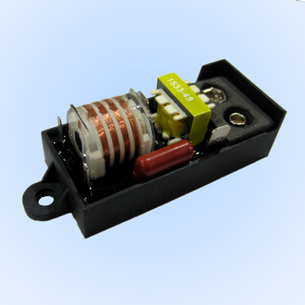

The ignition would be a HV source such as a stungun (of course he didn't just attach a stungun to it). (Jager, as you are a sponsor of the site I can remove this info if you want for your marketing interest..)
No need to remove. We do offer a low cost ignition module http://ultimatespudgun.com/product_info ... cts_id=219

Cute lil thing ^^
It looks like it works exactly like a stungun circuit with a questionmark hovering over the low voltage switching method.
