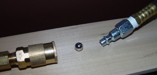

I just had an idea and tried to put a 3/8 steel ball inside a standard tool air quick coupling from Home depot... it seems to fit perfectly!!!!!!
With a little piece of thin rubber to improve the seal against the ball (maybe not even necessary) we may have here a perfect high power trigger for 3/8" steel balls. 8)

wow...
That's beautiful!
Really nice work here man. I suppose an air coupler makes perfect sense.... I'm definitely being inspired.
And I think you are the first to think of this..
Did you try shooting one out? All you'd have to do is slide back the coupler...
and it should shoot out!
Try it!
That's beautiful!
Try it!

Well, see, iltbsu, there's a reason those couplings don't spew all the air out of your compressor whenever you unhook an air line.
But it would be simple to remove the check mechanism in the coupling. After that, your only obstacle would be attaching a barrel.
Nah, can't shoot !
As mark.f said it needs some additional work to remove the closing mechanism. I have no idea how this can be done, I need to examine more closely the inside of the coupling or find a link that shows that.
I'll try to check if the air pressure is well sealed with a ball inside using my small workshop compressor.
I thought about this- I was thinking- if I understand the workings of it correctly- the spring inside it controls the check valve- when the coupling is inserted it pushes that back and releases air.
What if you make a projectile with a smaller rod coming out the back that would open the valve?
This would solve one of the problems I was thinking about- controlling the flow of air when reloading..otherwise it would just stream air unless you used something to control the reservoir, which is an unnecessary complication.
Also, how would you reload this? Right now I'm seeing a manual reload, Welrod type reload..
you could move the coupler back from the barrel... But then you'd have to move the reservoir as well..

Well, you can get the couplers without the check mechanism in them, or you can take it out. I forgot how to do it, so I'll see if I can find a coupler to go toy with.
The idea came to mind but I never actually made a prototypeLeMaudit wrote:Please Jack, don't tell me you already experimented and documented that idea! Please, please, someone else, at least
This could easily be turned into a semi-auto with burst disk performance, I've been thinking about the concept and will make a few drawings/animations when I'm home.
