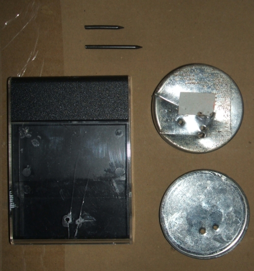

Thoughts of an automatic nailgun let me to do some testing with this launcher to determine the sort of performance obtainable with unstabilised nails. I used two lengths of 3mm wide hardened steel wall nails and fired three shots with each, respectively 1, 2 and 3 metres away from the target, which was a pellet tin backed by an acrylic box, starting with the shorter nail.
As you can see, it was fine up to 2 metres but by 3 metres the nails were hitting the target sideways. The longer one did however appear more stable, given its greater inertia.
Here's the target and ammunition:
