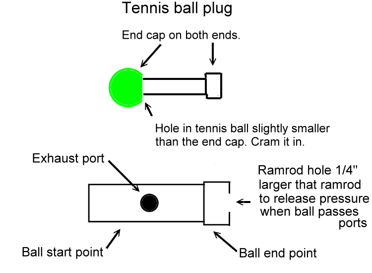

Independence Day is coming soon so I made a barrel attachment that uses a tennis ball as a burst disk without actually shooting the tennis ball. I have too many houses around me to actually fire anything in my neighborhood.
Once the tennis ball passes the two exhaust ports, it is stopped with an end cap. a ramrod is permanently attached to the tennis ball and is guided out of a hole in the end of the cap.
This should make for rapid reloading and firing. The pressure created by the tennis ball should make a nice loud BANG! Hmm...wonder what my C:B ratio is on this thing. :D

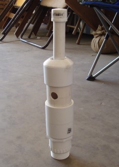

plunger up
plunger up

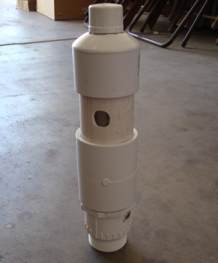

noise maker2.jpg (31.18 KiB) Viewed 8407 times
plunger down
plunger down
noise maker1.jpg (33.71 KiB) Viewed 8407 times

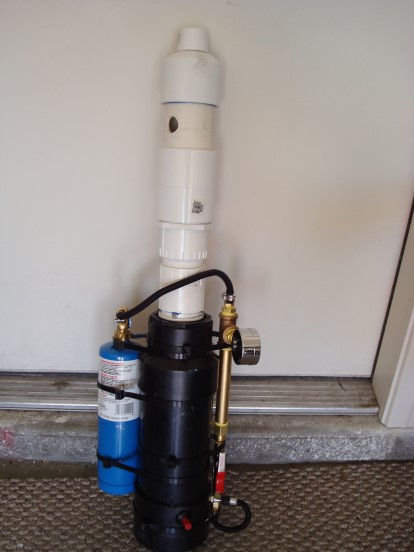

Here is is attached to the chamber
plug is permanently attached so measure many times before gluing it together. An end cap is on both ends of the ramrod.

For those who don't understand, could you post a diagram showing the internals?
Again, very nice work.
