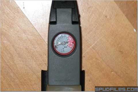

My super cool pump with it's super cool guage - it can go up to 12 bar which is 175 psi. ive only brought it up to 140 because its teriible hard to pump anymore and also becuase my gun leaks terribly after 120 psi. - teflon tape to the rescue !
