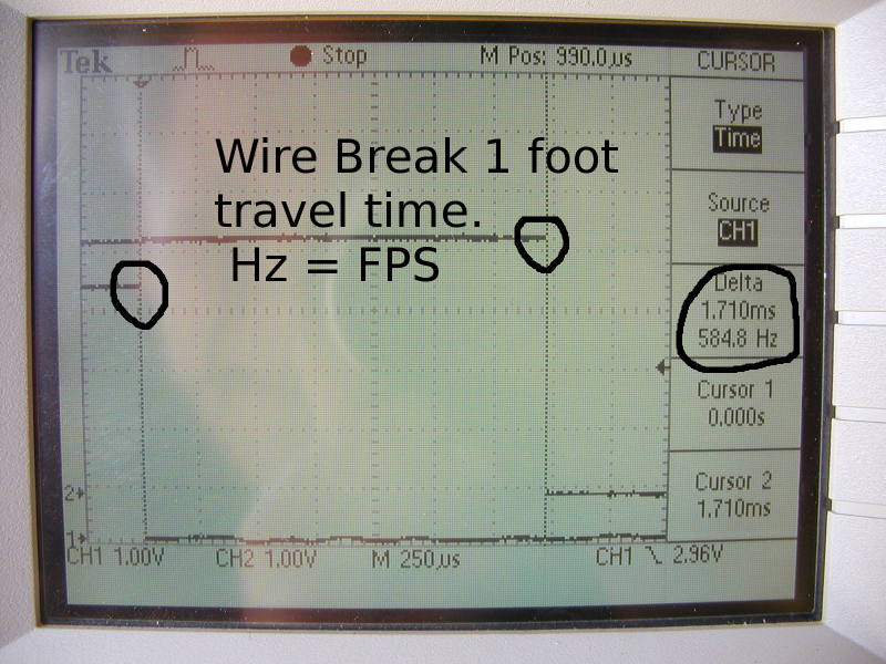

Wirebreak test shot.  Scope instead of sound card is used.  584 FPS in 1 foot travel.

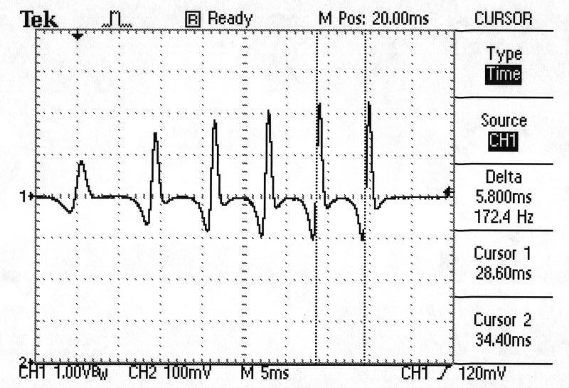

20 PSI test shot with a rolled up shirt in a 3 inch barrel.  Position detected every foot of travel for acceleration calculations.  Magnet and pick up coil detector.
