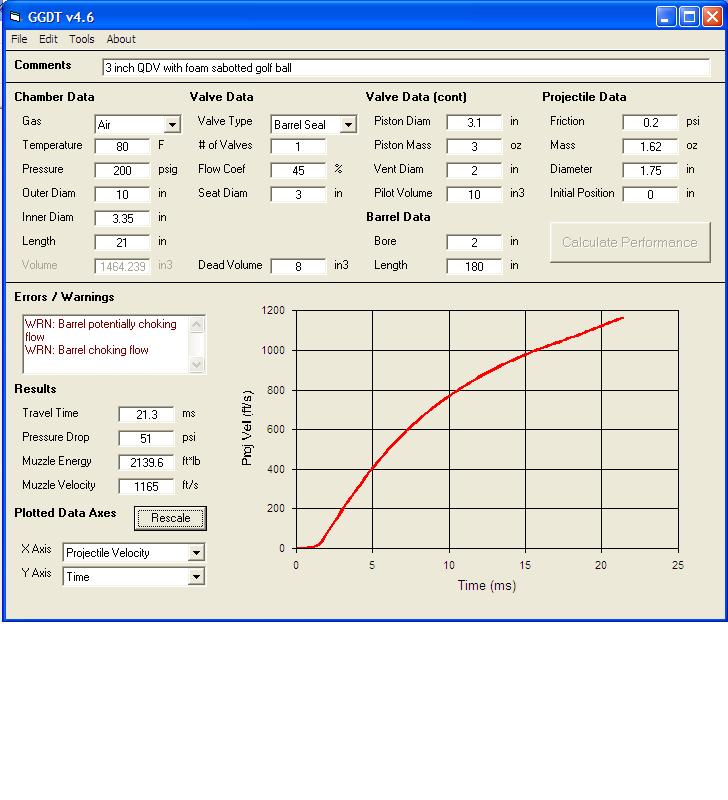

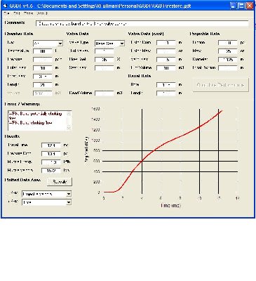

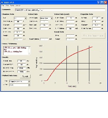

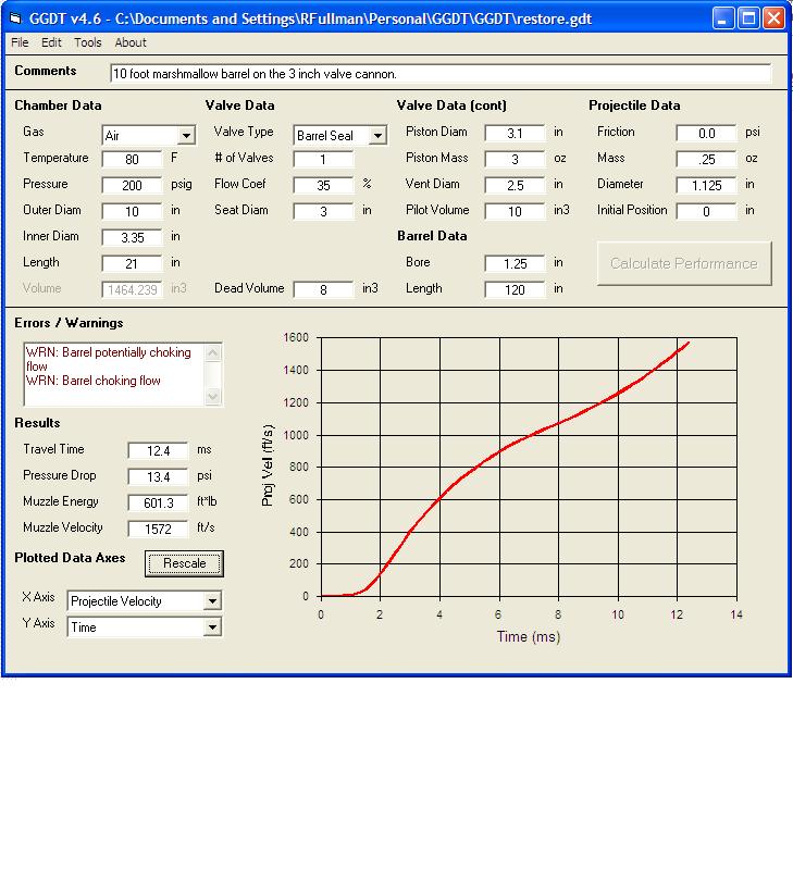

Light projectiles in my launchers are over 700 FPS. Chronograph and video confirms it. No projectiles clocked supersonic yet, but supersonic airflow is seen. Next project is an attempt at it.
Larger valve and higher pressure may do it. GGDT predicts supersonic. Moving to lighter projectiles runs the speeds supersonic in GGDT. Long barrel, high pressure, large valve, and larger diameter barrel is required for the higher speeds.
http://www.spudfiles.com/forums/ggdt-an ... 18090.html
http://www.spudfiles.com/forums/quick-d ... 17858.html
Door dented with a marshmallow

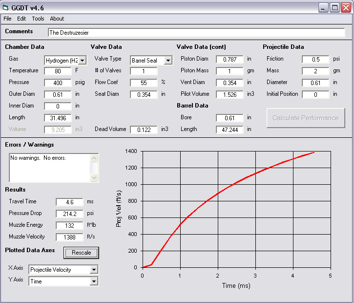

- inonickname
- First Sergeant 4
- Posts: 2606

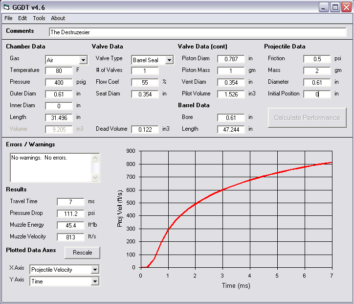

15.5mm bore, wadded marble, rifled..
I'd bet my left leg that the Q-tip guns pulled this with ease, bordering on mach but they nolonger exist, unfortunately.
- 400 Psi air (from stirrup)
- my gun 1.PNG (30.76 KiB) Viewed 7279 times
- With hydrogen pumped with stirrup (derived from NaOH + Al)
- my gun 2.PNG (30.56 KiB) Viewed 7279 times

Are you trying to model trans and supersonic pneumatics, or are you trying to figure out how to make a pneumatic go supersonic???
I ask because "according to ggdt" almost all of mine should be well beyond SS, and while all of them are consistently measured in the high transonic region 950-1100 fps, the only one that measures supersonic is the decimater, and there are several of us trying to figure out how it's actually achieving what shouldn't be possible given the gas being used.
To get a pneumatic to go supersonic with air or co2, it takes more than just pressure and efficient valves, it takes things like venturi effects, compression heating, pressure front collisions(my theory on deci's performance), projectile "stiction", projectile seal, and projectile initial postion.(the last 2 having effect on compression heating the gas)
I think modeling performance will be tough, but modeling what it takes to get SS performance will be tougher...
- inonickname
- First Sergeant 4
- Posts: 2606
That's a common complaint with GGDT, it's overly generous near the sound barrier. If it sounds implausible then it's good to doubt it.

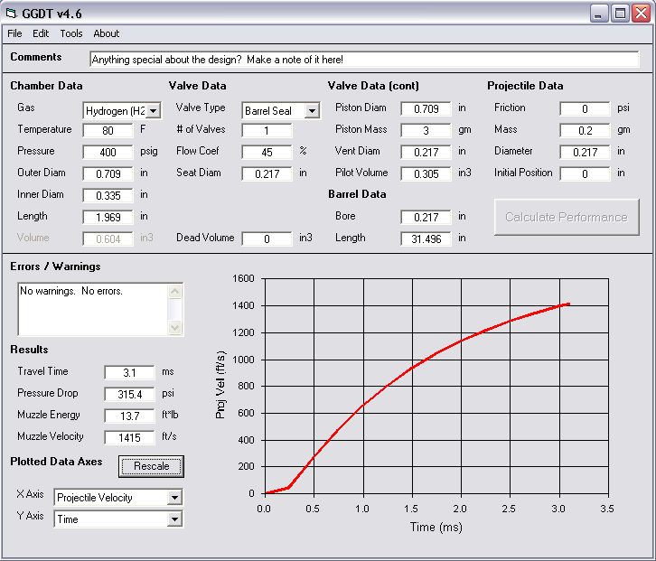

- inonickname
- First Sergeant 4
- Posts: 2606

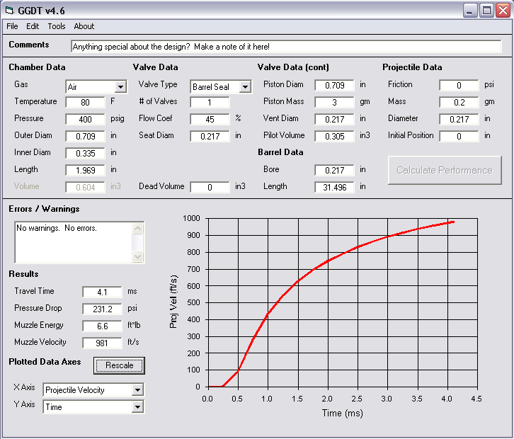

Moar the merrier?
Simulation of my next-gen Q-tip gun..decided to take the idea further. I'm expecting it to perform much better than the last. Smaller pilot volume (much smaller), lighter piston, faster pilot flow..it will be a cup shaped piston much smaller than the chamber (co-ax).. (the piston will be much lighter than it is, and P.V. will be lower than there..)
With hydrogen it exceeds the U.K. legal limit for air rifles..with a Q-tip..
- Beware, I'll smack your 12 ft/lbs legal air rifle in the face ;p
- next gen q-tip gun hydrogen.PNG (31.1 KiB) Viewed 7095 times
- Plain 'ol air..
- next gen q-tip gun.PNG (31.31 KiB) Viewed 7095 times
