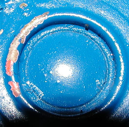

Disposable freon tanks use these, but have a section where the disk is retained instead of ejected completely. The freon tank on the inside has a flow restricting orifice, so when blown open the orifice is about 1/4 inch in diameter.D_Hall wrote:I'm thinking that for a large bore gun burst discs can be problematic. It occurs to me however, that a solution may be a shear disc instead. More to the point... A disc with a thin permitter and thicker middle that forms the aft end of the projectile. The disc is held firmly at the breech end much as a burst disc would be.

I retained this disk on my T Shirt cannon, but it's highly unlikely to pop at any of the pressures I am using.
The thin stamped ring at the edge of the disk is easy to see.
