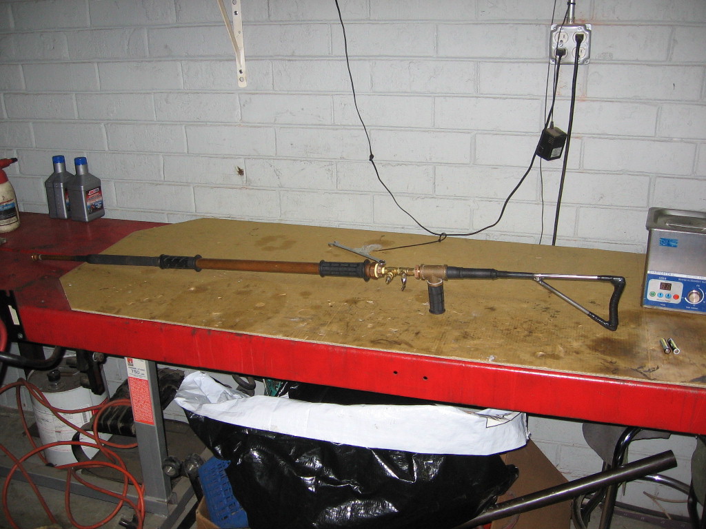

And while I'm updating this collection thread, here's a coupla pics of the new firing control/vent/stock setup I put on the copper cane posted in the OP...
Full port BV venting the coax's pilot volume through the 3/4" Tee/3"nipple handle, the rear leg of the the tee has the homemade stock... ergos are just about perfect for me, and no NOTICED loss of performance from switching from qev/blowgun to bv, prolly because the pilot volume shrunk with this layout, and pulling the "trigger" is prolly less than 1lb of pull required... Next nice day I'll get some vid's of firing it...

- Posts: 26220
- Been thanked: 352 times
very nice
any chance of some target videos?

Does the muzzle break have any effect on the recoil of the cannon? Or is it just on there for a badass looking muzzle blast. Either way, it's still pretty cool looking.
That looks nice indeed!
The handles look good, and I like how you vent through the handle as well.
The brake is quite effective, before the brake it would stand the tripod on it's rear leg(even when held with 2 hands) and that video I'm firing singlehandedly...
