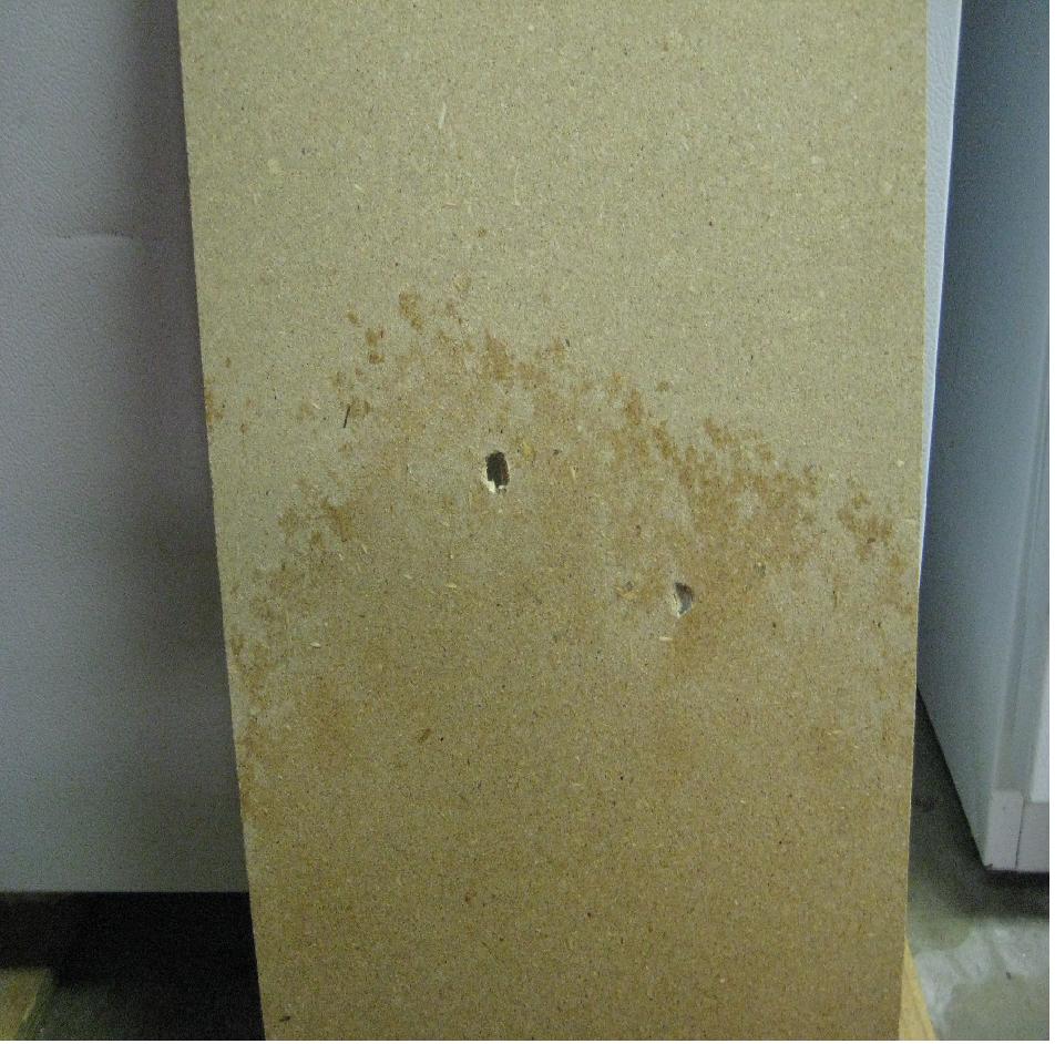

this is my first pneumatic and second gun, the chamber is about 16-18" total of sch 40 pressure rated 1" PVC, but because some of it is above it is a little over 1' long. the barrel is just under 2' 6", the valve is a half inch ball valve, the schrader is from a bike tube and epoxied in with J B weld, which seems to not stick good to rubber but still made a seal, but needed to be fixed.I got all parts but the schrader and ammo at Lowe's, and I used all in one pvc "blue glue" to seal the parts together.
