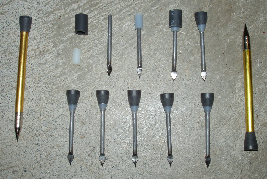

This is my fix.

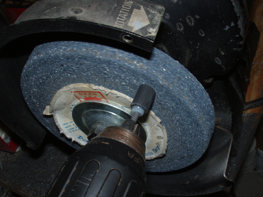

The tubing used is nylon. The larger tube is 6.5 Mm Id, 10 Mm Od, and fits perfect in a 40 cal. blowgun. It fits a little lose over the small tube but if it fit any tighter it would be hard to slip it on with super glue on it. The small tube is 1/4" Od, 1/8" Id, and fit tight over the shaft. I had to get some vice-grips and force the shaft into the tube.

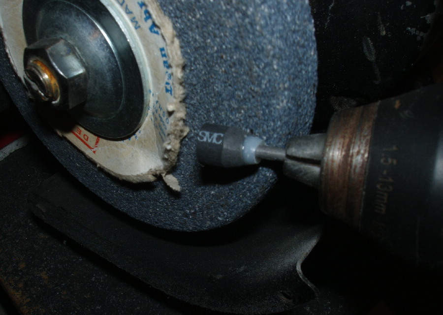

So, I cut a bunch of small tubes at 3/8 inch and the big tubes at 1/2 inch. Slip the small tube so the shaft is 3/4 the way thru it. then put the big tube about 3/4 the way over the small tube, as shown in the pic. use super glue on the shaft and between the tubes. let it dry for 24 hrs. If you don't you will get bugers when you try to grin it. Also make sure you run the drill in reverse or the opposite way the grinding wheel is turning. This will help keep plastic burrs cleaned off.
These cones will not collapse. At 400 psi the dart will go clean through a solid 2x10 from 50 feet away. The cones of coarse pop off.
The larger darts in the picture (pistol crossbow bolts) will pearce just through the other side.

I leave a flat area on the end of the cone. This effectively holds the smaller darts centerd.
Yes, the old cones work great but won't hold the 1/8 inch shaft. I tried drilling them out but wasn't happy with the results.
I used nylon tubing. polypropylene works well too. I would think any semi hard plastic tubing that didn't crack would work. High density polyethylene (HDPE) is another good type. Getting the right size for your barrel is the important thing.
