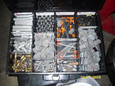

The best nail darts I've found are the powder fastener nails( aka remington, paslode, RAMSET, etc) just push the orange finned collar to the back of the dart and use a sabot... an fyi, these things are perfect in a .40 cal blowgun barrel with just a wad of paper as a wadding... They're also hardened for use in concrete and steel...that's what they're designed to penetrate... midlle compartment in the row second from the right...
